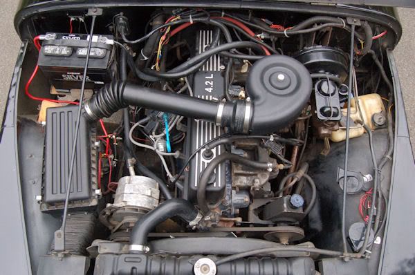

Try the plumbing department of Lowes or your favorite hardware store. When I did the EFI conversion of my Scrambler some years ago I needed a reducer to adapt the tube of a TJ factory air intake to my GM throttle body - the reducer that connects the air tube to the "snail" on top of the throttle body in the photo below came from Lowes. If I remember correctly, they had a few different sizes, maybe one will fit your application.
