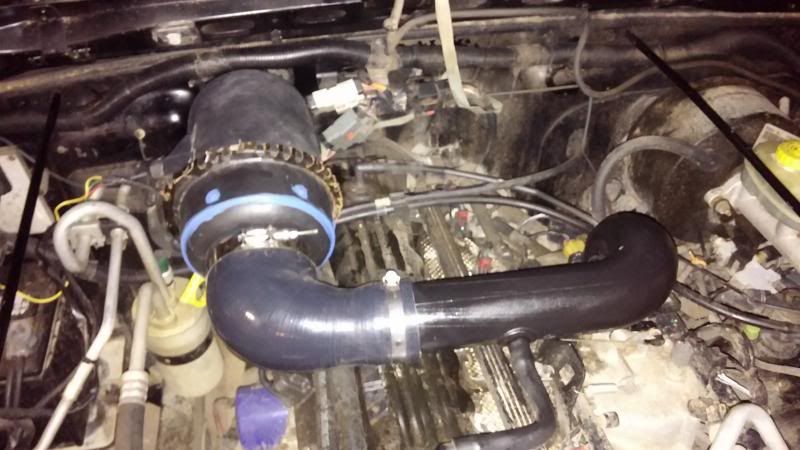

After doing this on my sons 99 TJ, I decided to dump my ARB snorkel on my 94 YJ and do this as well. However I found a few things different that I had to trouble shoot.
First is, there is a difference as to where the oil vent tube is on the YJ. It sits back further and is almost under the TJ Air intake tube. It was difficult to find a hose that would fit without kinking, but I found a short elbow tube at the auto parts store.
Then there is the vacuum line from the charcoal canister. There isn't any place to connect it on the TJ Air tube. I think it's connected into the side of the TJ intake manifold, but my YJ manifold doesn't have a spot for it. So I found some Adaptor plugs at the auto parts store. Just had to drill a hole into the TJ intake air tube and press it in. Then run a hose to the charcoal canister.
There is also a length difference to the firewall. I made mine based on the same length as the TJ and my setup sits at an angle. I was going to get another wind star box and cut one longer, but decided not too as that would put the TJ air intake tube right on top of the valve cover PVC tube and I would be back to square 1.
Also the rubber boot that goes into the cowl wall sits up at a semi steep angle. I was worried about water getting dumped into it when getting washed or a Florida down pour. So I cut a peace of tin and riveted it over the top to prevent a direct hit from water. I had to trim the cowl grill so it would sit flush over the tin as there is a lip on the inside. All in all it worked out. But it is louder than the TJ. It sounds like a vacuum cleaner at 2000 RPMs. Going to take some getting used too.
Hope you can make sense of the photos.
