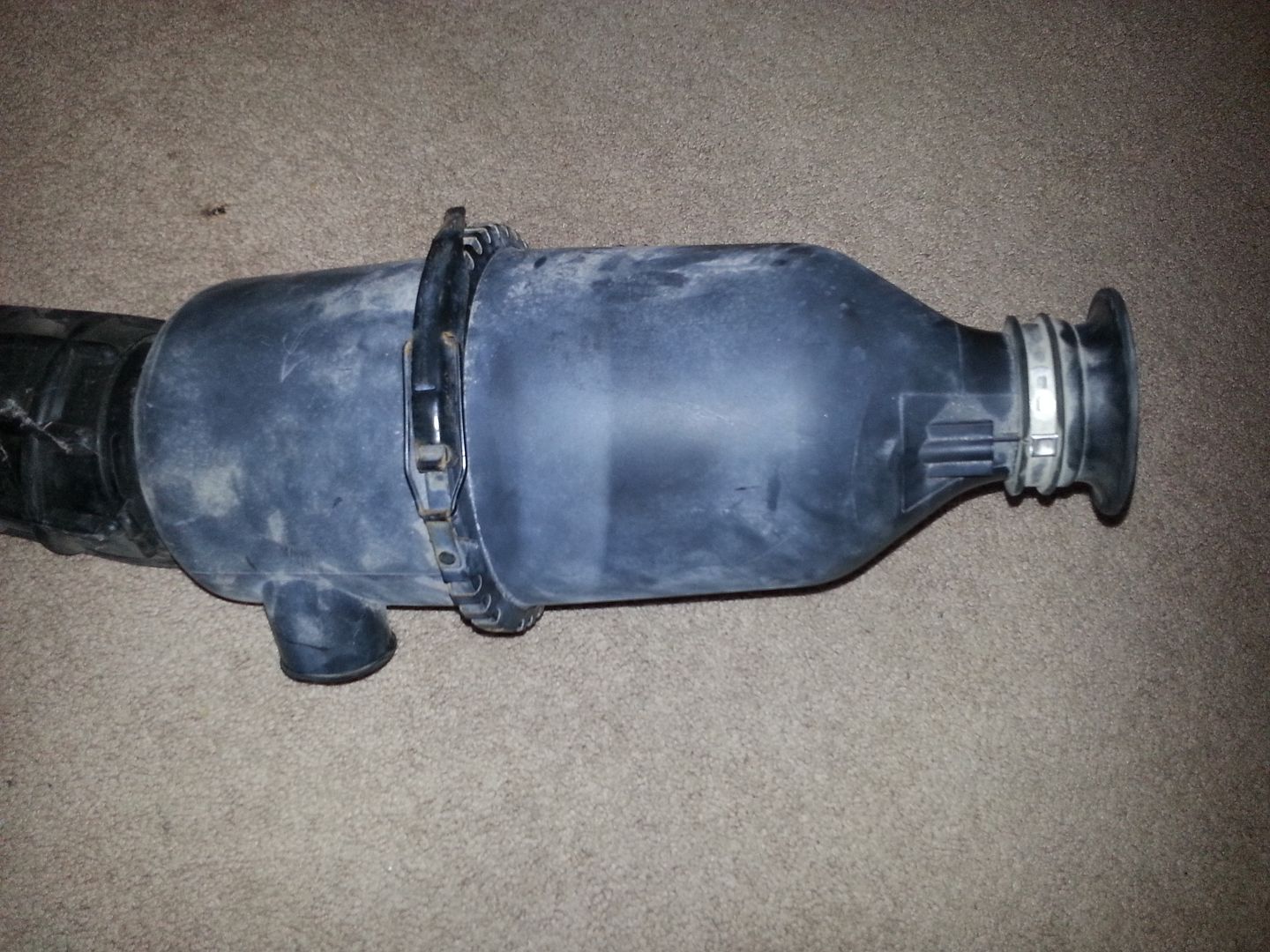

Originally Posted by Ironhead View Post
that elbow under the cowl would put it directly under the vent, causing water to drip right into the air intake
ps, mine is off an 01 as well, but saved a ton of space by cutting it down
Looking at your setup it looks like you have the original intake tube still attached and under the hood going through the firewall? I didn't get the original end piece, so the end of the air box is actually what I have going through the firewall, hence the 2.5" hole vs the 3" others have referenced and the closer non-modified fit.
Yep, the oem windstar setup uses that to get behind the front fender. Makes the fit nice and clean going through the firewall

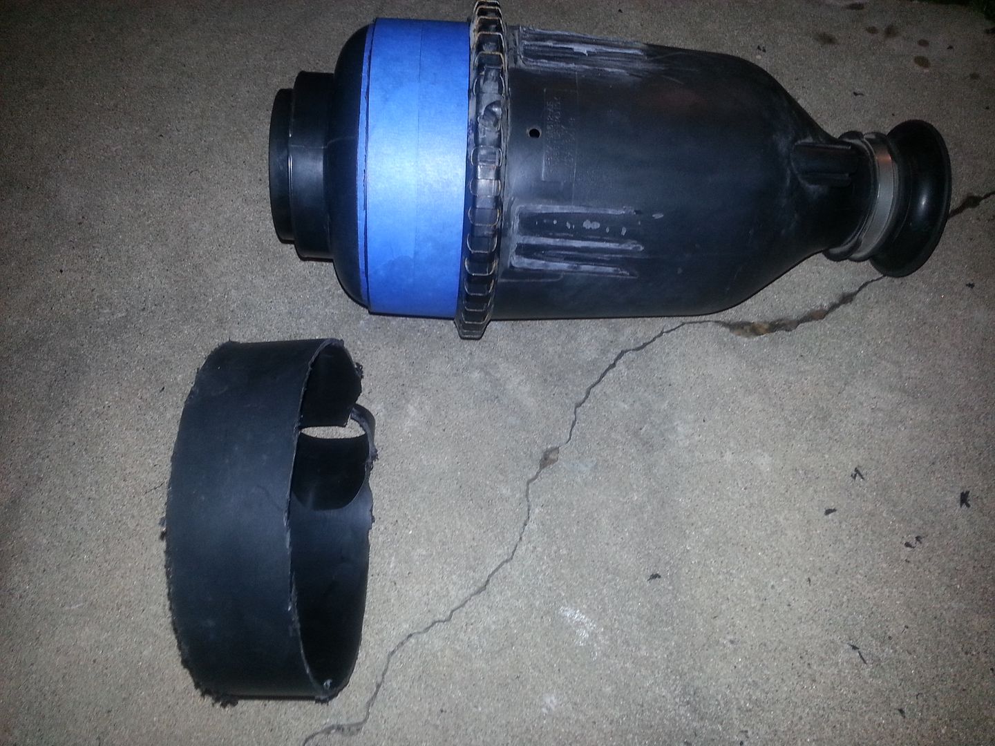

Got this guy for $21.59 today. Now to order the elbow. Ironhead, where did you get your reducing elbow and why silicone?

Ok I went with a 4" - 2.75" we shall see how that does. Also, has anyone just used black RTV to seal their box after cutting and not used rivets? If so, how is it holding up?
Started it BTW, will see if I need to trim more once I cut the hole and get the elbow from UPS.
