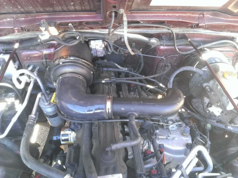

Installed Windstar cowl intake
I just did the mod today, first major mod I've made to my 2000 TJ.
A few things that I did a little differently (for better or for worse):
I used the airbox from a 2001 Windstar. When I was at the junkyard I had first pulled one from an older model, then I found the 2001. It was a bit smaller, which ended up being a bonus since I didn't have to cut it. Plus I got it for $15.
Instead of the 4" to 3" elbow, I found a 4" to 2.5" here: This was the most expensive part at $31.04 shipped. It was a bit of a tight squeeze on the stock pipe, but a little WD-40 helped.
My hole into the firewall was 2.5". I also had to move my ground wire and undo the clips on the wire bundles running through that area so that I could run them under the airbox. On the cowl side of the hole I put a 2.5" elbow, tilted slightly down. This also acts to seal the hole and adds extra support to keep the airbox from sliding back into the engine bay, although it holds pretty well even without this. With this setup, to change the filter you just undo the clip holding the two pieces of the box together and swing away the portion attached to the throttle body, similar to stock.
The airbox was a little long, so the pipe back to the throttle body is not exactly perpendicular across the engine like stock, but it works just the same.
TBD on any performance or efficiency gains, but I can feel it sucking and could hear it slightly when accelerating at 2500+ RPMs on my test drive. Fun mod that took me 3-4 hours.

post #147 of 254 Old 10-06-2013, 11:20 AM
mrcleanjeep
Join Date: Jan 2013
Location: Pekin
Posts: 107
Man,that's about the best idea i've seen yet..nice job
I'm fairly certain that is the same air box we all used. Either way you may still want to shorten it.
2003 Rubicon
jjvw is online now
post #149 of 254 Old 10-06-2013, 11:42 AM
Ironhead
Location: Westchester
Posts: 4,403
that elbow under the cowl would put it directly under the vent, causing water to drip right into the air intake
ps, mine is off an 01 as well, but saved a ton of space by cutting it down

nickhamm
Join Date: Aug 2013
Location: Louisville
Posts: 17
Appreciate the info guys. I hadn't seen anyone reference the 2001 model and the others seemed to be bigger since the fit on mine was so close without cutting it down. Based of this info I'll probably cut mine down as well.
As far as the intake tube being directly under the cowl vent, I thought dripping could be an issue, which is why I angled the tube down so that any water coming in would drip over and down. I actually drove it in pretty steady rain the other day without issue. But now that I think about it, better safe than sorry, and I'll try replacing that elbow with an piece of 2" tube I have.
