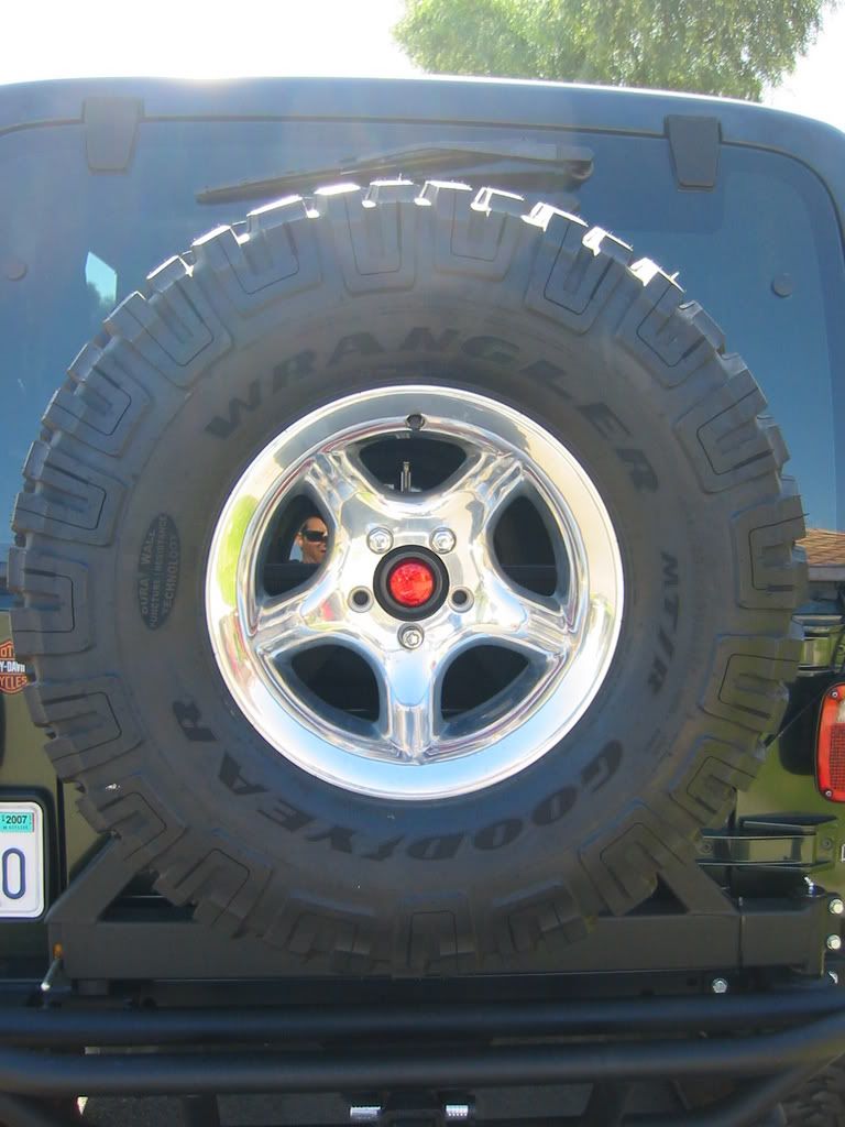

thanks road king..... they little high anyway $700
I will check ebay, i just want some stock ones, like alloy's or the rubicon ones.
Check here in the classifieds too.
If interested...I'm selling these rims for $350 + shipping for 5 rims:
