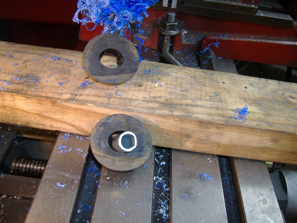

Well, I got if fixed. Found bushings at the auto parts store. It's a Moog poly bushing # K3176. Can't believe how easy it was to change. Wouldn't have taken 10 minutes it I hadn't decided to modify the bushing hole. The old rubber one had a nice machined inner sleeve that was .750 and the new one was .625 and rolled out of flat stock. I bored the poly bushing to fit the old inner, greased it up and put it back together. Cant believe how much better it drives. Wobble is gone, wandering is gone, steering is way tighter. All is well with the world again.[IMG][/IMG]
