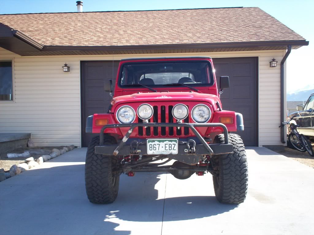

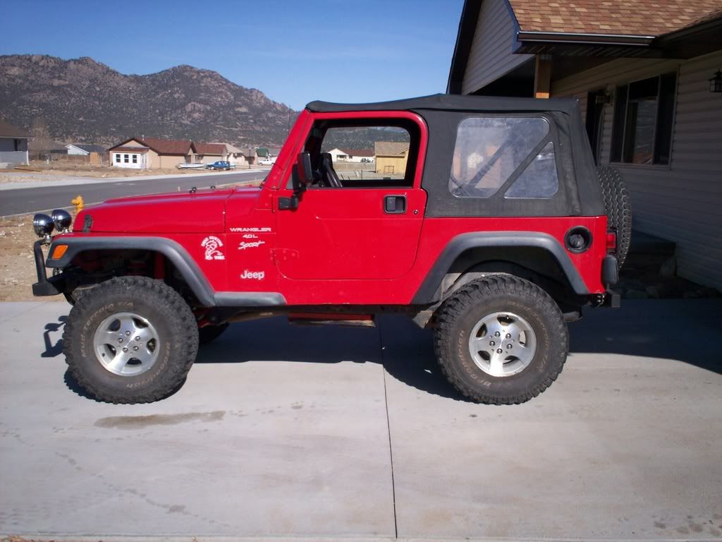

I just put on 33" BFG Mud Terrains on mine with a 4" Tomken lift and no body lift. I still have power to run on the highway. I have a 4.0L 6cyl running 3.73 gears. I have stock breaks and axles " For Now " Just accuired a Ford 8.8 for a later this year project. Doing mine aon a budget.
It will still wheel too.
Hope this helps
BV Jeep
