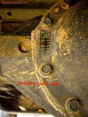

Are you looking at the correct numbers?Where the circled numbers are should read 307 or 373.

I dont have a tag on the rear. But on the front it says something like that on the tag. I have the rear open and was looking at the ring gear reads what I posted, not the tag.
Usually the ring gear will say something like 11:41 (for example) which would be 3.73.
But, since 43:14 is 3.07:1, I think that's what you have.
Also, if your front has a gear ratio tag, the rear should be the same.

the front tag does read 3.07 according to the picture you have posted. I am still not sure if the PO re-geared though which is why I am asking.
