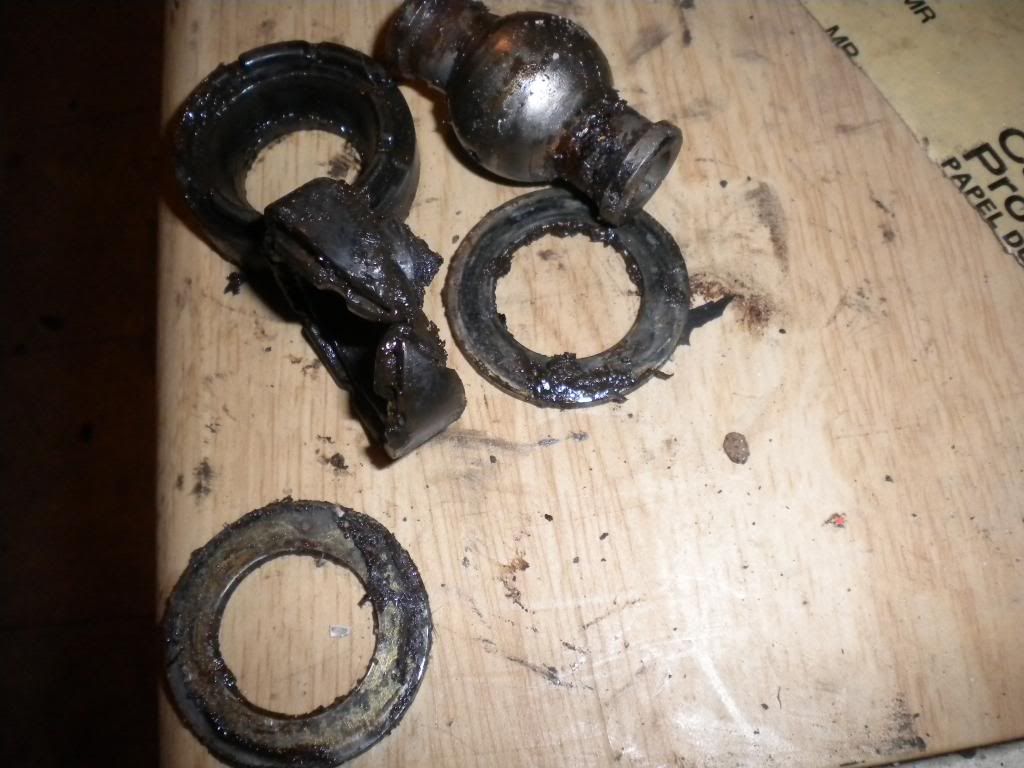

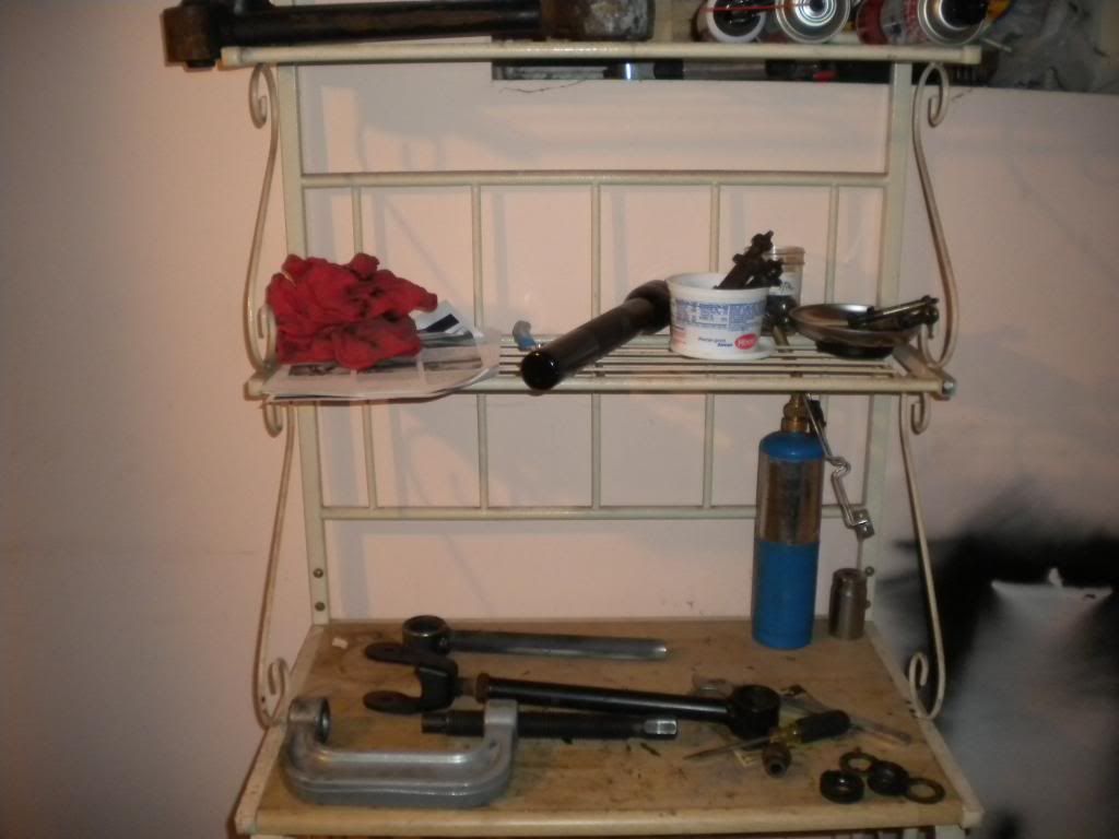

Bought a pair of currie front uppers with a toasted bushing - so in my crappy apartment basement I made a little work station and a bastardized all thread/socket method to break down the johnny joint for rebuild
This bushing was busted badly and I couldn't get the joint out so I had to melt the thing
I think its time for new bushing...everything else looks okay though so I'm happy with the deal
I've got the centering ball and greasable bolts sitting in a degreaser solution overnight...hopefully I'll be able to reuse them and just get the rebuild kit of bushings/washers
