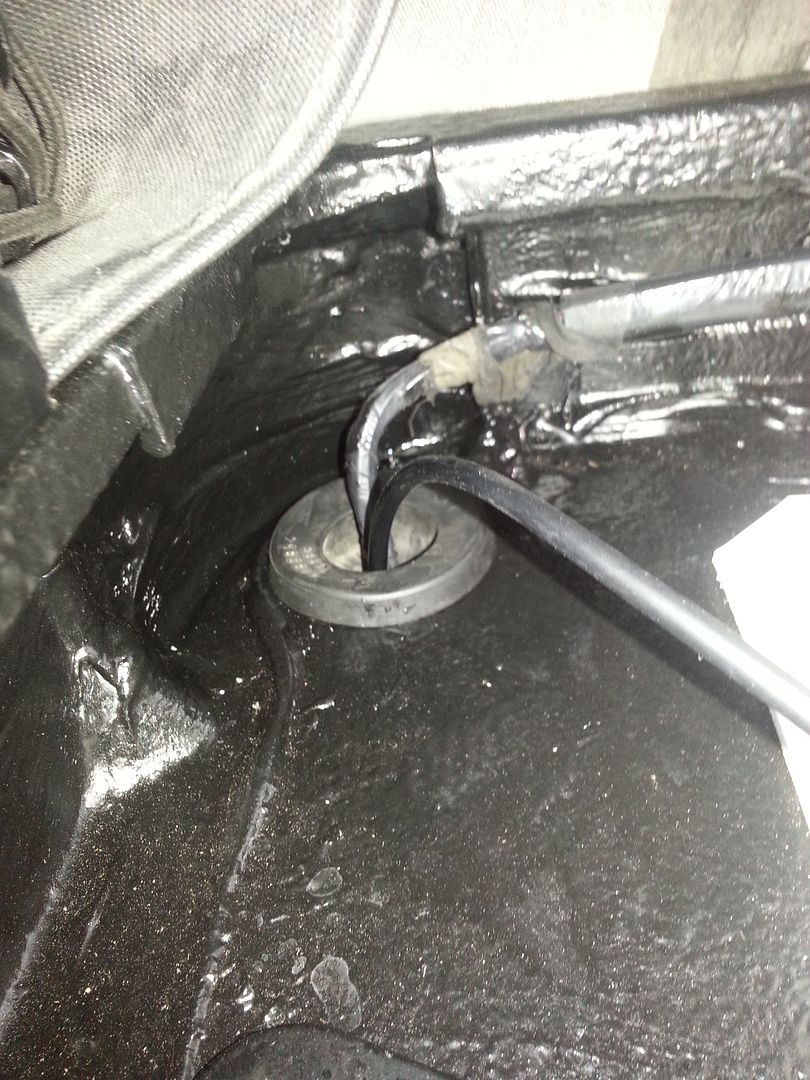

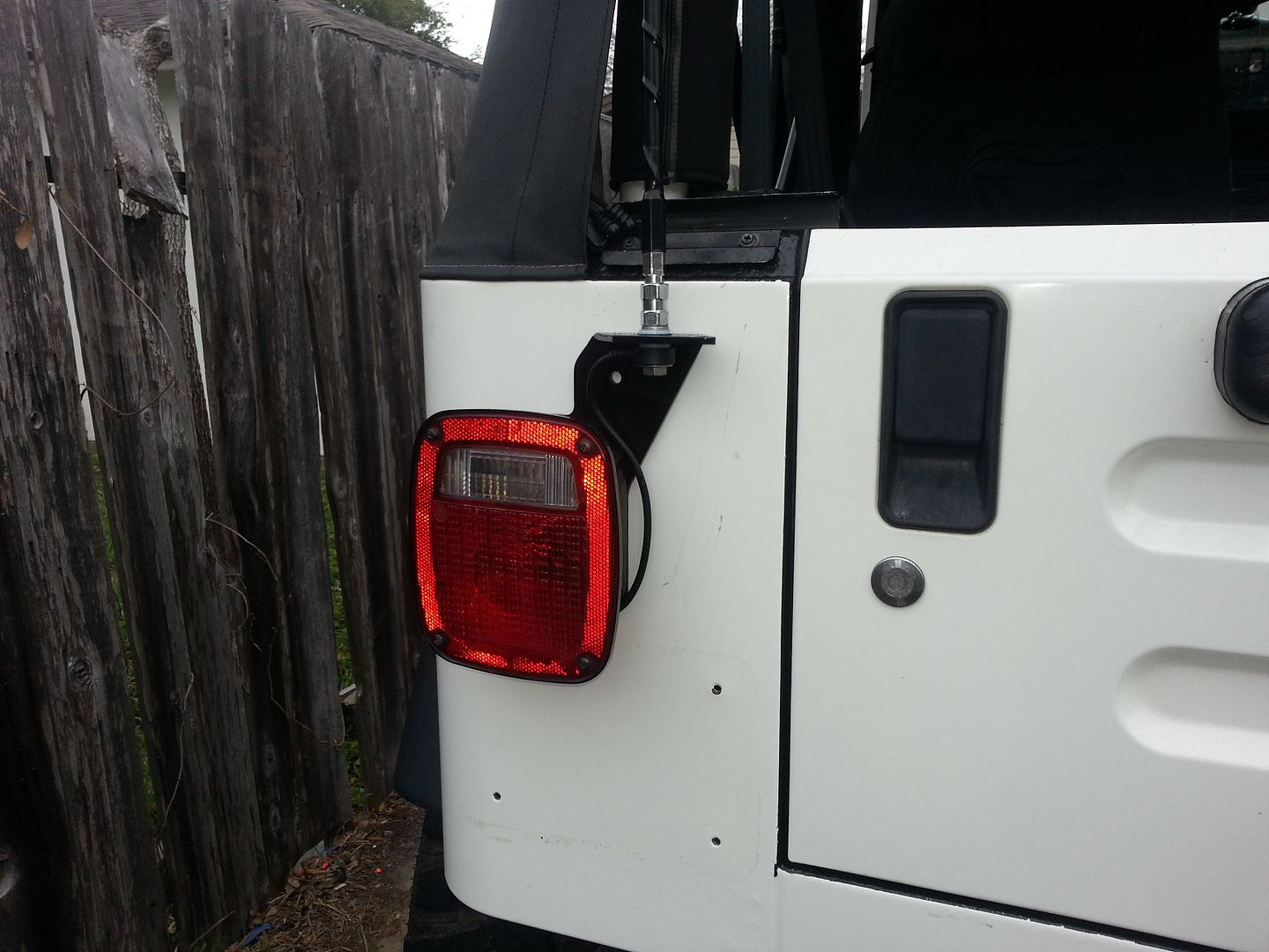

CB antenna mount painted and installed. Ran the cable through the gap at the bottom of the light and up through the rubber gourmet in the corner of the tub. I like the clean look versus having it mounted center on the tailgate with a cable running across it.

bbradUSMC;
It looks like you have the right side antenna mount on the left side. Not an issue unless you run the hardtop and can't open the back window.
I'm looking to add one (or two) of these mounts to my Jeep. I already have 2 VHF antennas on the front beside the hood, but need at least another radio for SAR work.
JeepUke1 is offline
post #92878 of 112552 Old 02-02-2014, 11:35 AM
bbradUSMC
Location: Corpus Christi
Posts: 2,195
Ya I have had it on the pass side on my last jeep, the reason I put it on the drivers side is so I can run the cable like I did and have a nice clean set up. If I ever get a hard top I will run it on the pass side and try to deal with running it through the tub like the brake light harness is ran. This was the easier route.
Originally Posted by JeepUke1 View Post
bbradUSMC;
