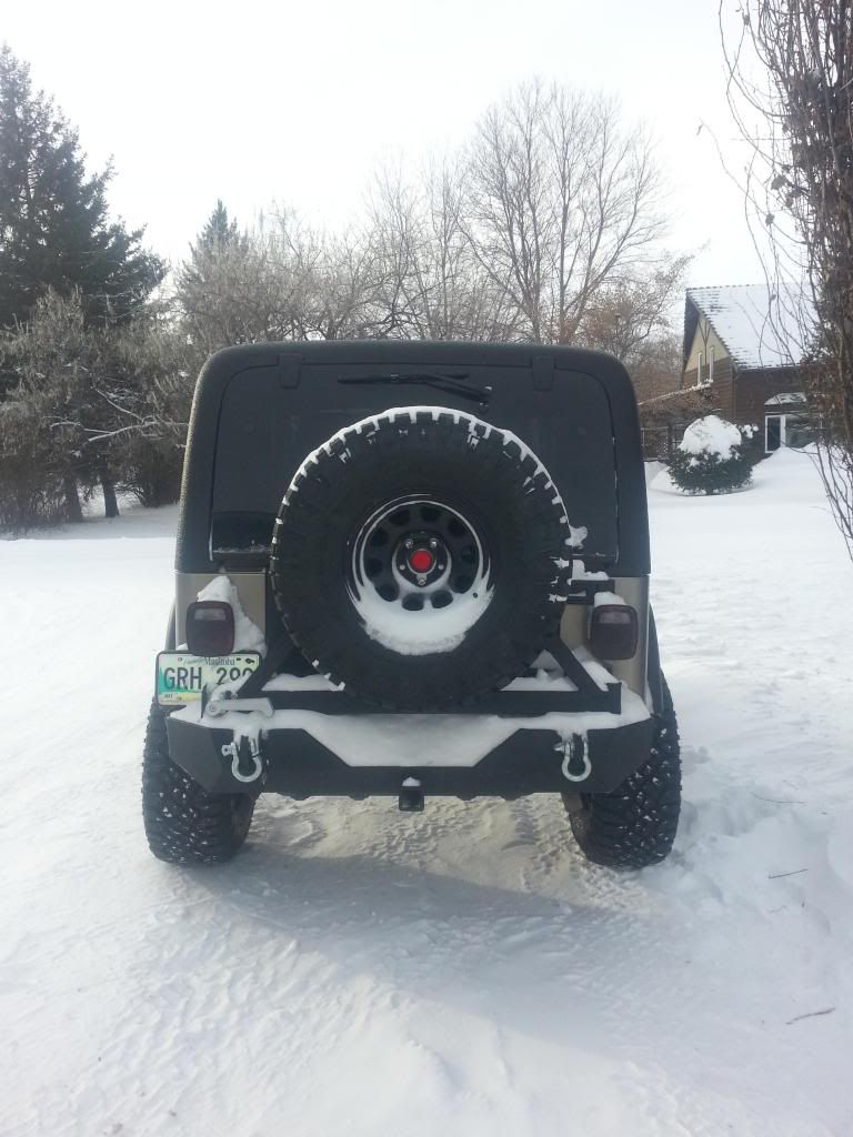

Nothing fancy, I installed a 3rd brake light in my spare with a flash relay. Cool and cheap!!
I'll tint it in the summer to match the other brake lights
