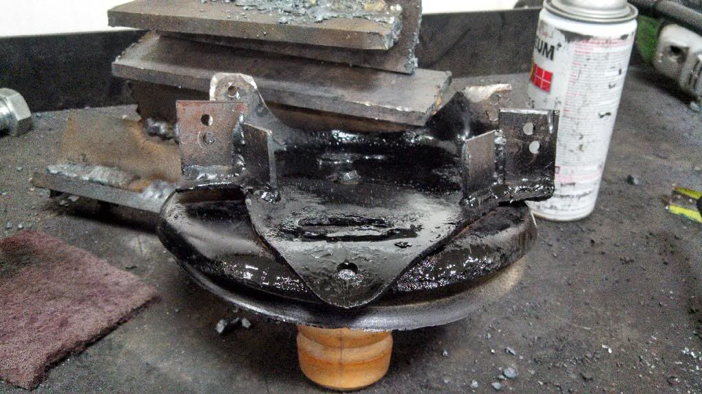

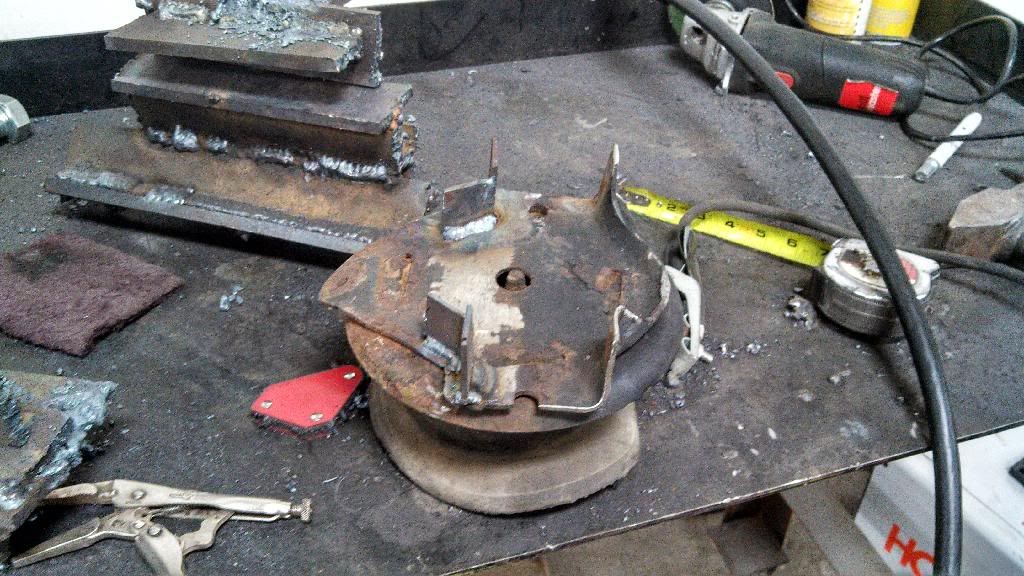

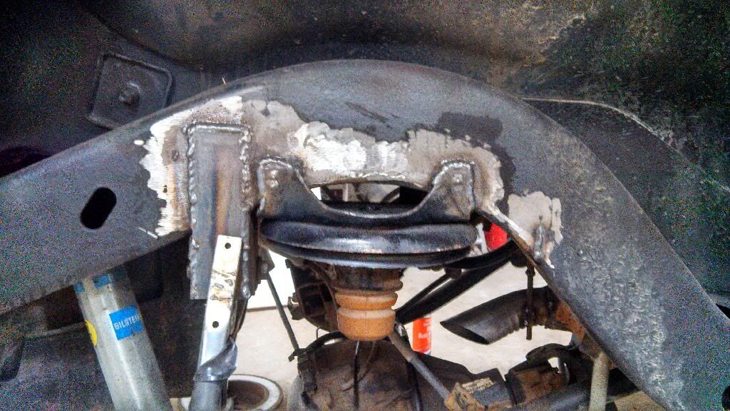

So far this week I have started my coil bucket relocation in the rear.
Had to build my own mounts for the backside, and shorten it enough in the rear to avoid the crossmember.
Also drilled holes to plug weld it to the frame.
So far one side is done.
