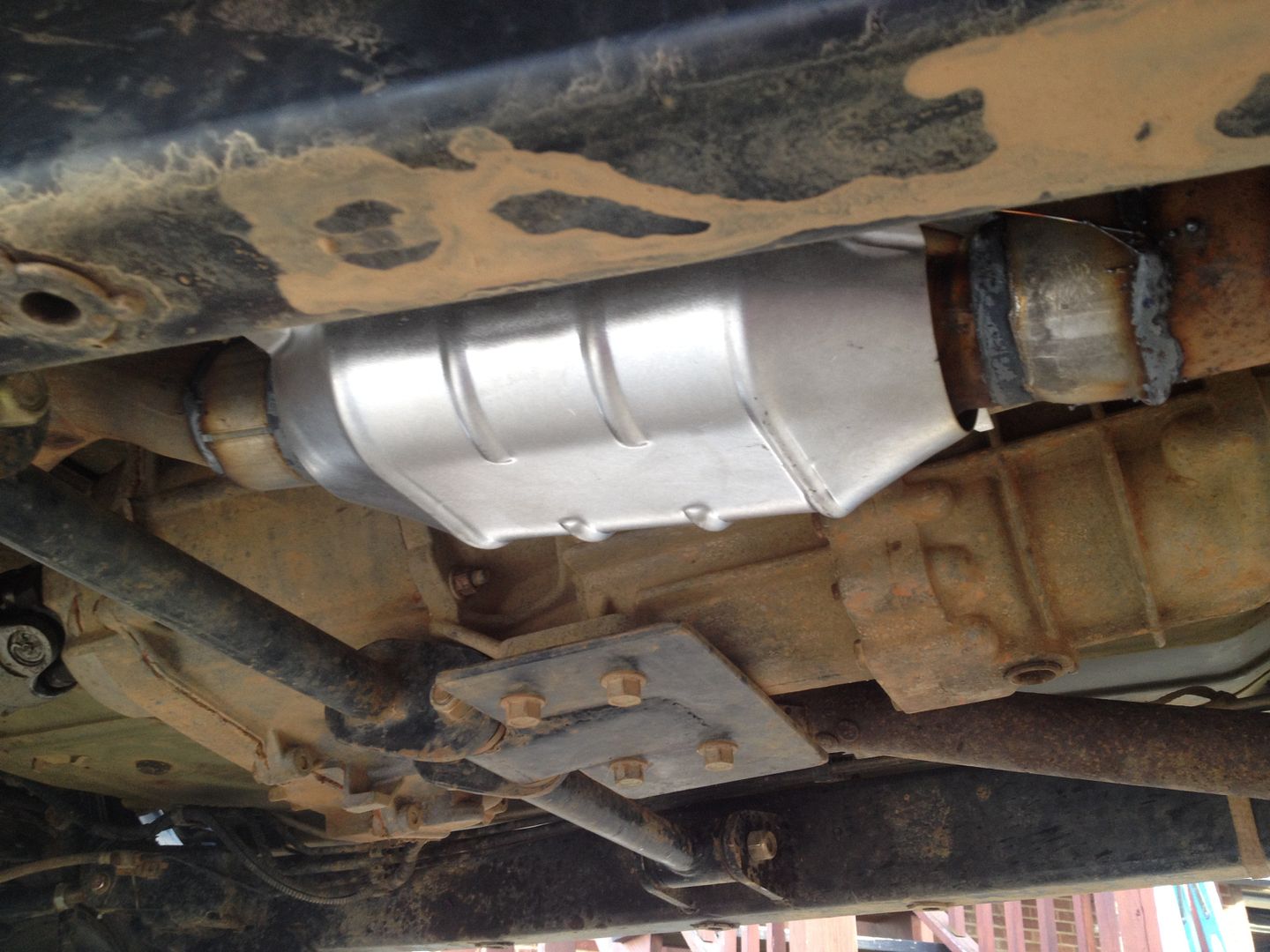

Washed about a hundred pounds of thick mountain clay off of it, then got a new Walker cat installed. Top side of flat skid still had some primer showing so I put on a thick coat and will bolt up tomorrow. Also bought the parts for a ZJ tie rod (inner had to be shipped in) and continued my electrical work.
Who makes that transmission support? I think I like that. Any problems with it?
* edit*
So a flat skid just uses the factory nutserts in the frame to fasten to?
One more edit lol. Is there vibration isolation?

I did. No.
Yes, because I made it that way.
Yes. No vibes.

You did a great job with that.
To get to that point what is needed , minus the support you made.
Novak transfer case cable shifter
did you have to use a super short sye?
DC drive shaft
obviously need adjustable control arms
do you use a motor mount lift or no?
what am I not thinking of?
Thank you for the response.

Yes.
Yes. JB Conversions
Yes. Carolina Driveline
Yes.
Yes.
1.25" Body Lift.

one last question (sorry) for the exhaust you just dont bother supporting it by the converter anymore?

There is a hangar at the front of the cat, which is welded to the frame. You just can't see it in that pic.
