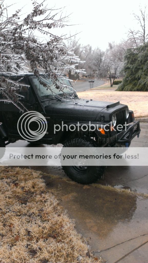

Came out to half an inch of ice on her this morning. Glad I have a soft top, makes it much easier to get the ice off.
looks like mine the last couple of days. 1in of freezing rain the last two days and about 10" of snow coming tonight.

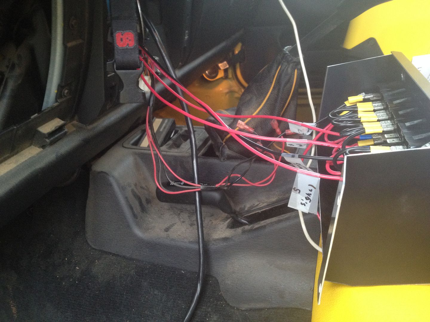

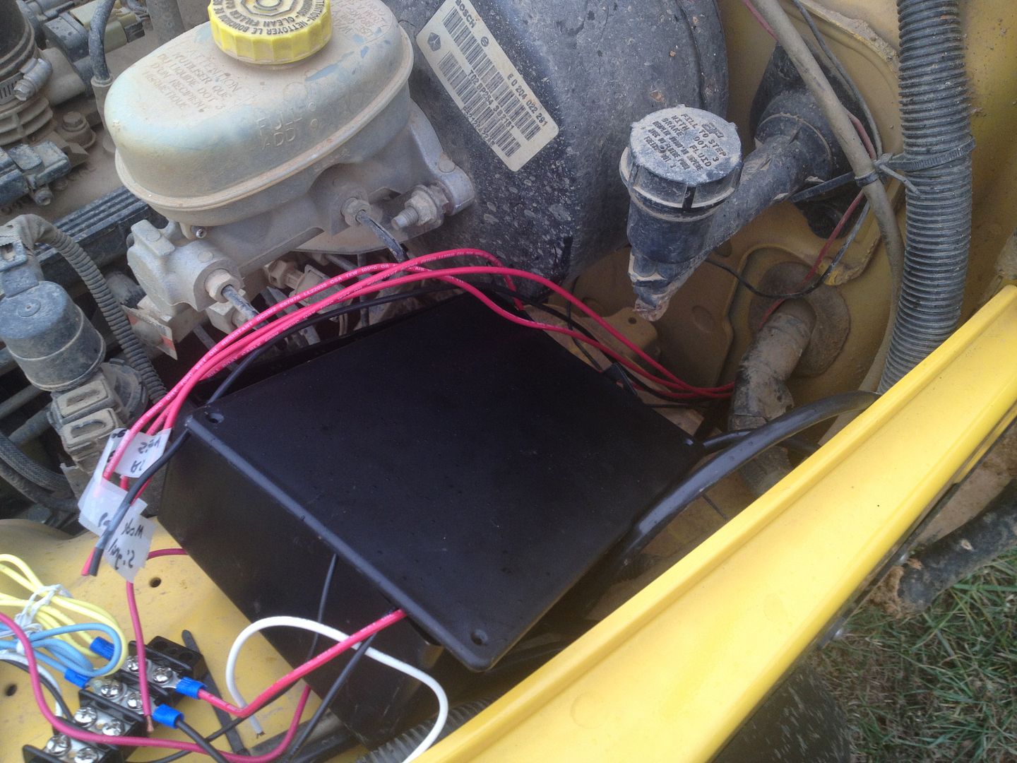

More wiring today.
Got the harness wired up to the M8000 control box. I didn't like the way the harness was designed to splice into the existing wiring, and I didn't have any male spade disconnects on hand so I cut the males off of the end of the harness, broke the shields off, and rewired it so I could use the In-Cab or remote without damaging the existing wiring.
I ran as much wire between the switch panel and fuse block as I could before it got dark. Labeled both ends so I'll know how to reattach everything when the panel is ready to be permanently installed (waiting to get back to shop and bend shifter). There will be loom on most of it and zip ties on the rest when all the wires are run.

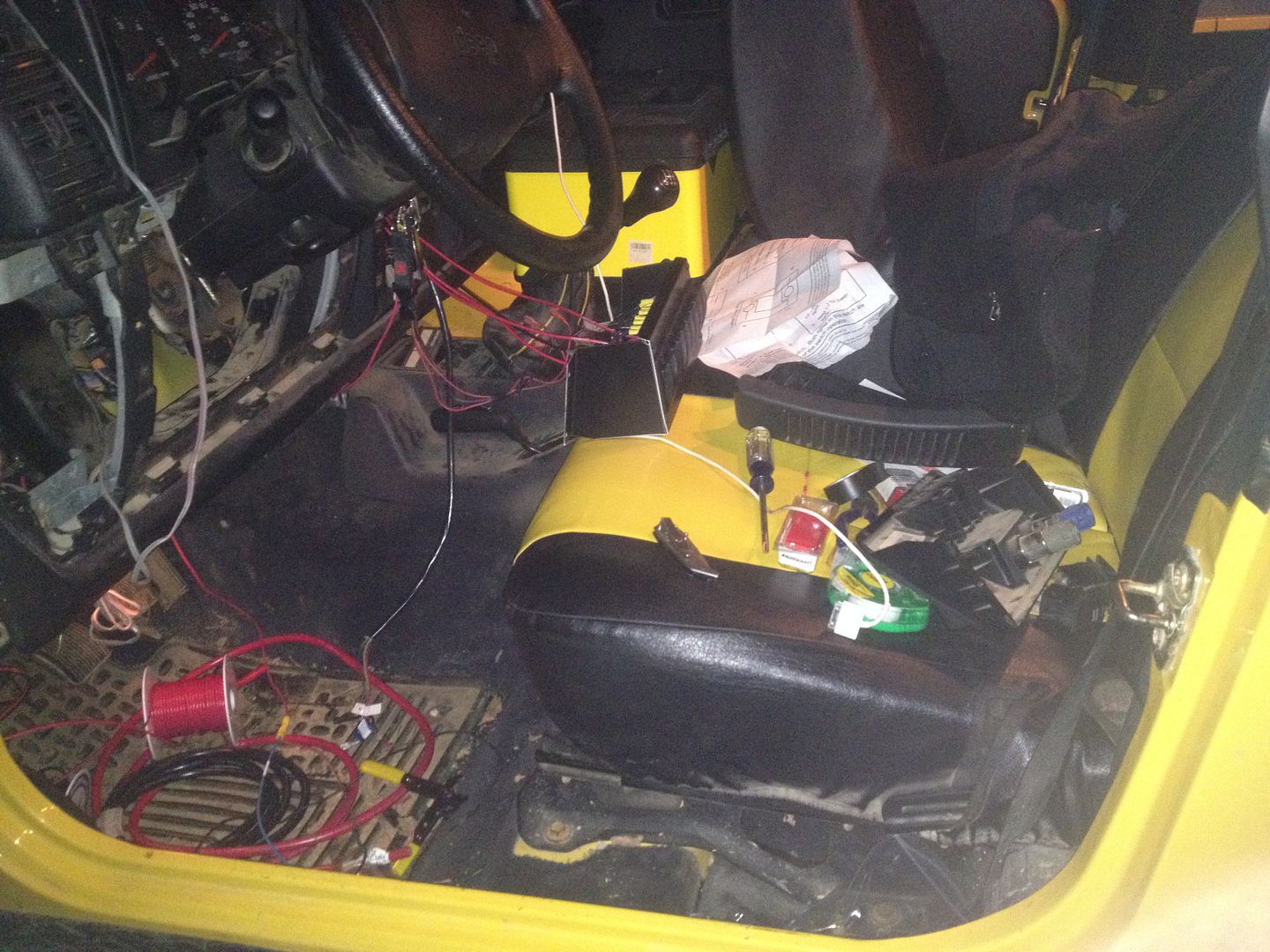

And here's the mess that was once the cab.
I really underestimated how much work this takes. Get a lot less done in a day than I would have thought.
