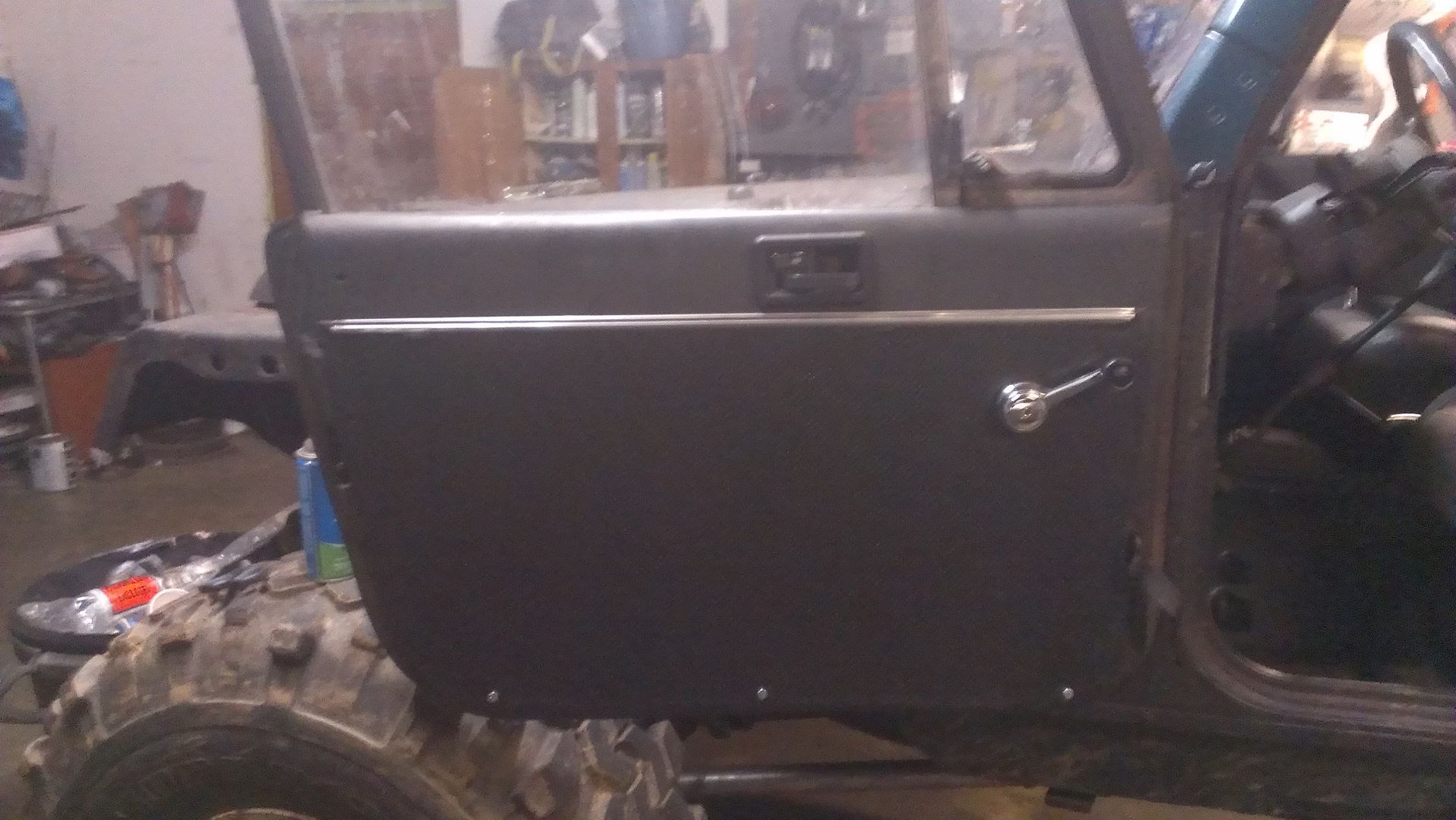

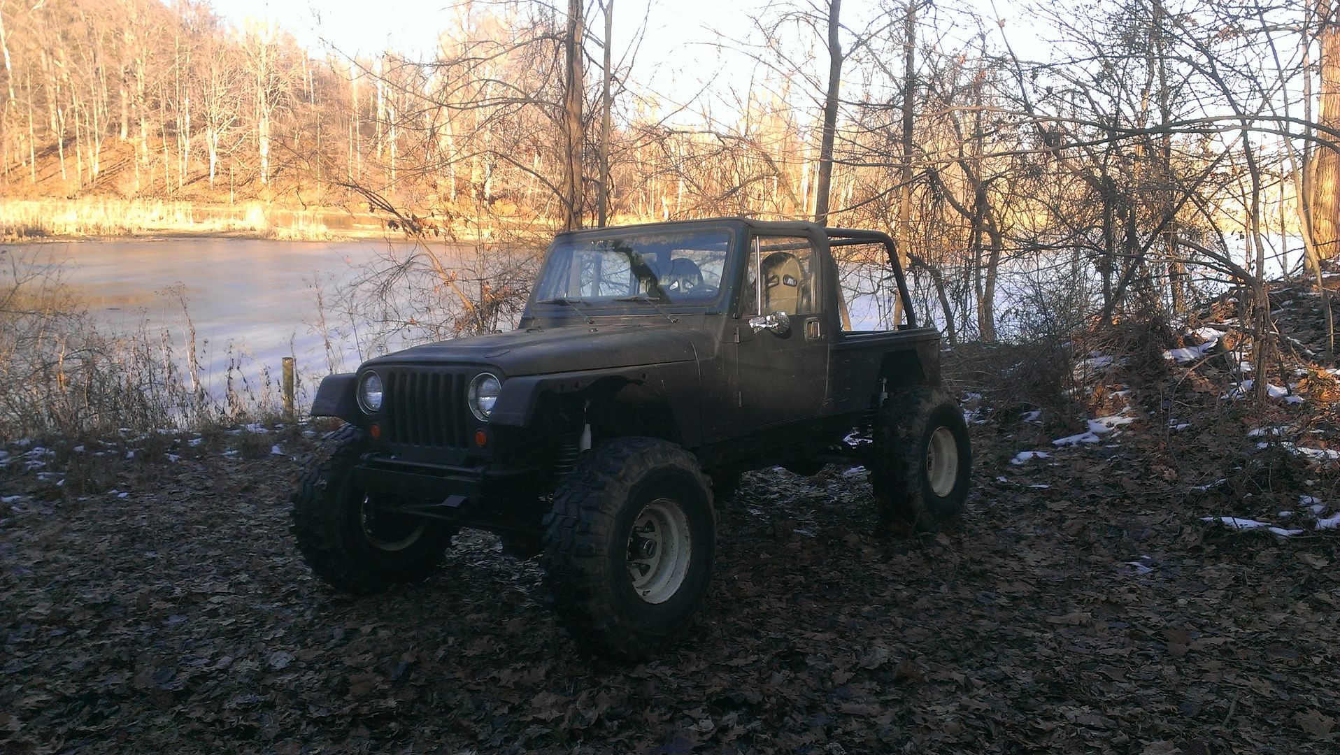

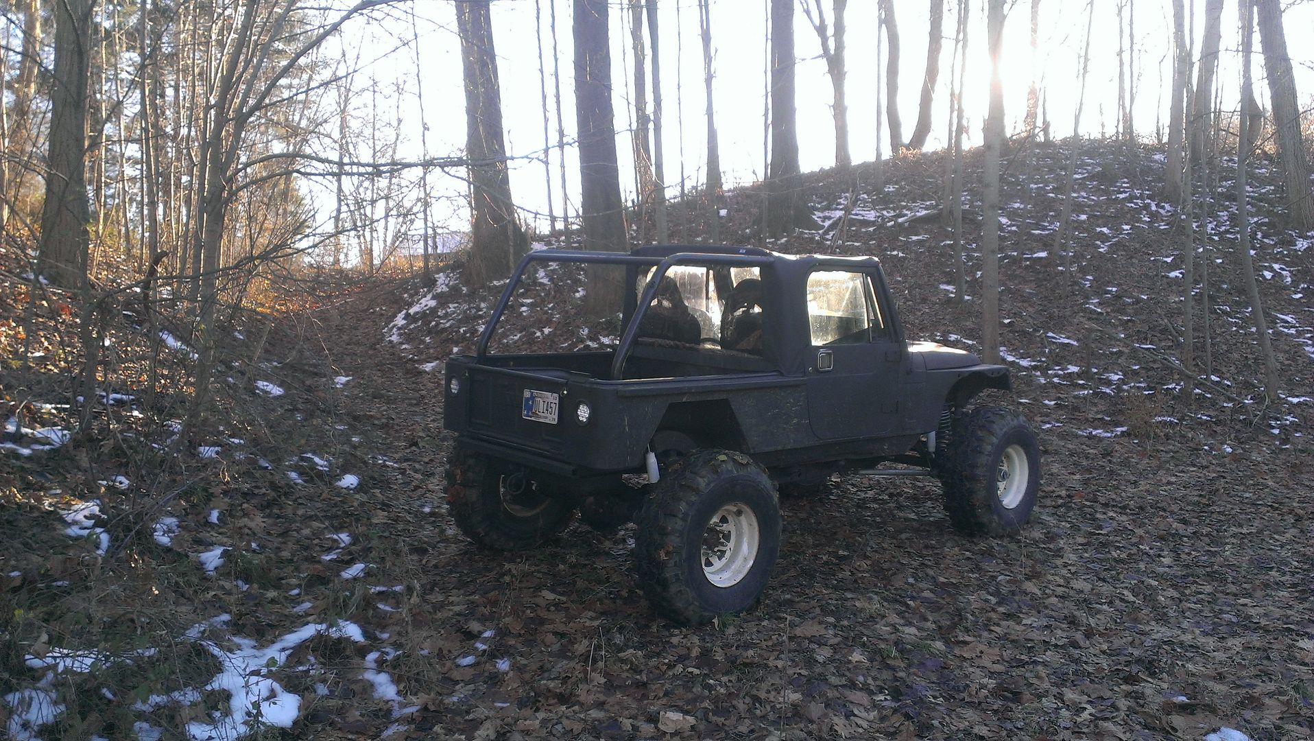

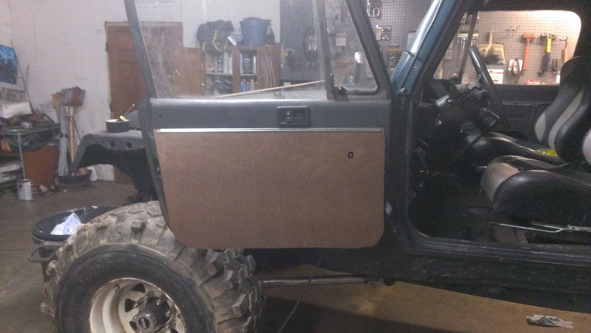

took it for a drive out back.
made some door panels for the cj/yj doors

Originally Posted by jarrodblake
took it for a drive out back. made some door panels for the cj/yj doors
You're jeep is hideously bad ***. Kudos my friend.
That is a wicked rig. Rear axle stretch and a highline up front?

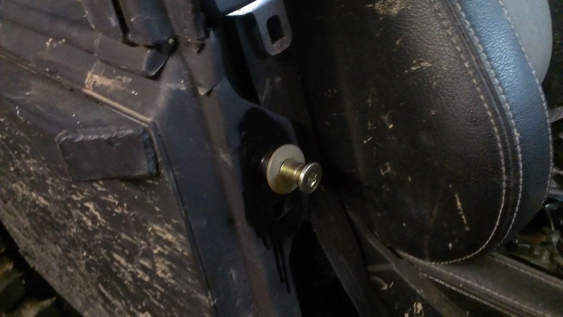

How much effort did it take to fit YJ doors on?
HaHa, thanks!
LJ tub specs with a 109 wheelbase and highlined stock fenders and hood.
Very little. replaced the striker with yj stile strikers and sleeve spacer using the stock tj upper striker hole. So no drilling then you just have to remove the speaker grill for the window cranks to work.
