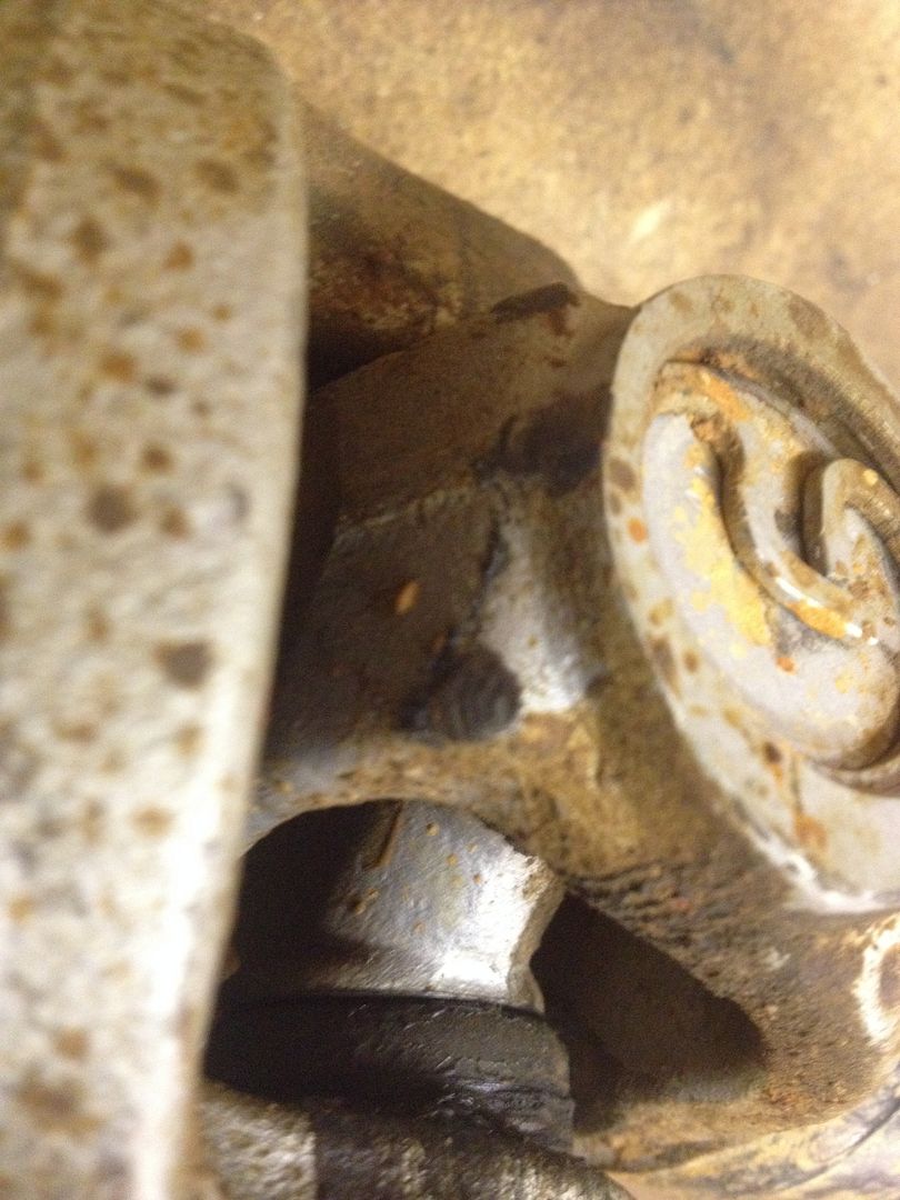

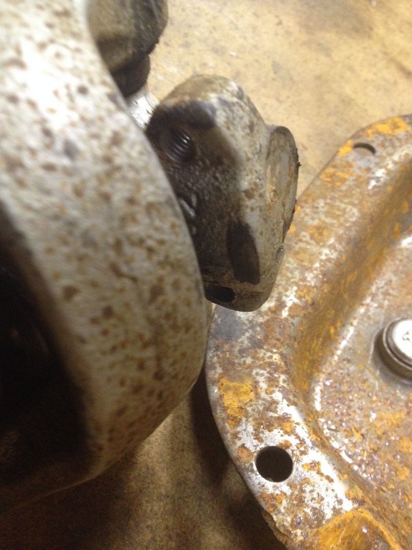

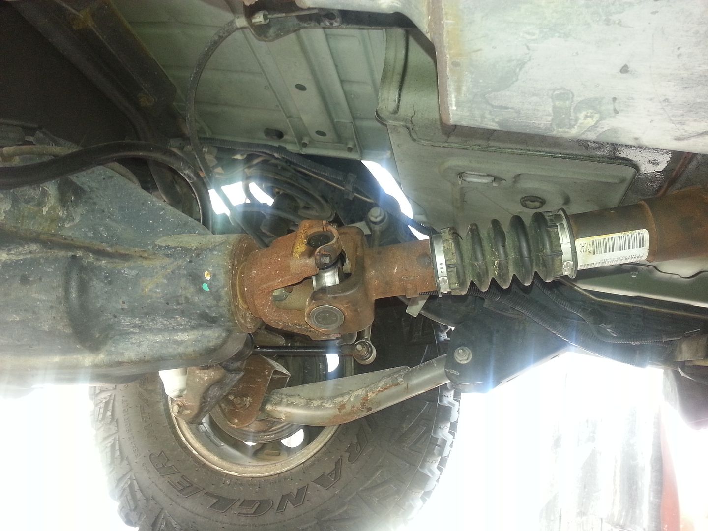

So I sealed up the rear and refilled with the cheap stuff. Reinstalled the shaft and the popping was still there (That fluid was terrible and needed to be replaced anyways). Pretty sure its the CV joint, after some questionable parking lot testing. Going to get a needle fitting to grease it tomorrow and hope that fixes it. It could be binding again, but it seems odd to me that it would randomly start doing it again after I adjusted the pinion angle last time, and the feel is different. FWD for now. I can't tell if these marks are new or from the first time it was binding:

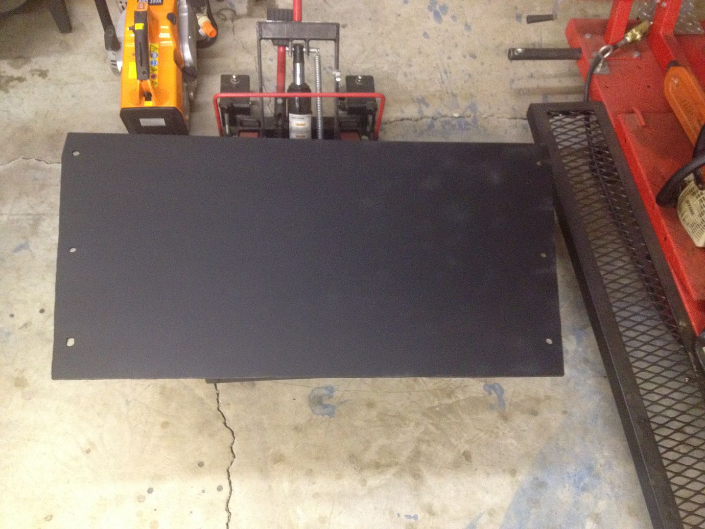

Nevertheless, I am almost done with the skid. Needs a couple more layers of paint and it's ready. Also started painting several of the 44 parts.

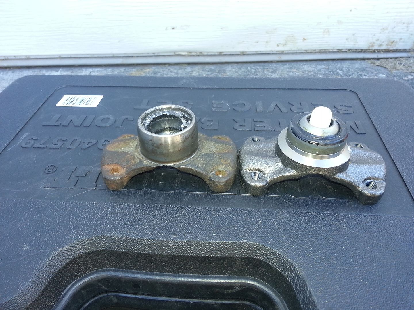

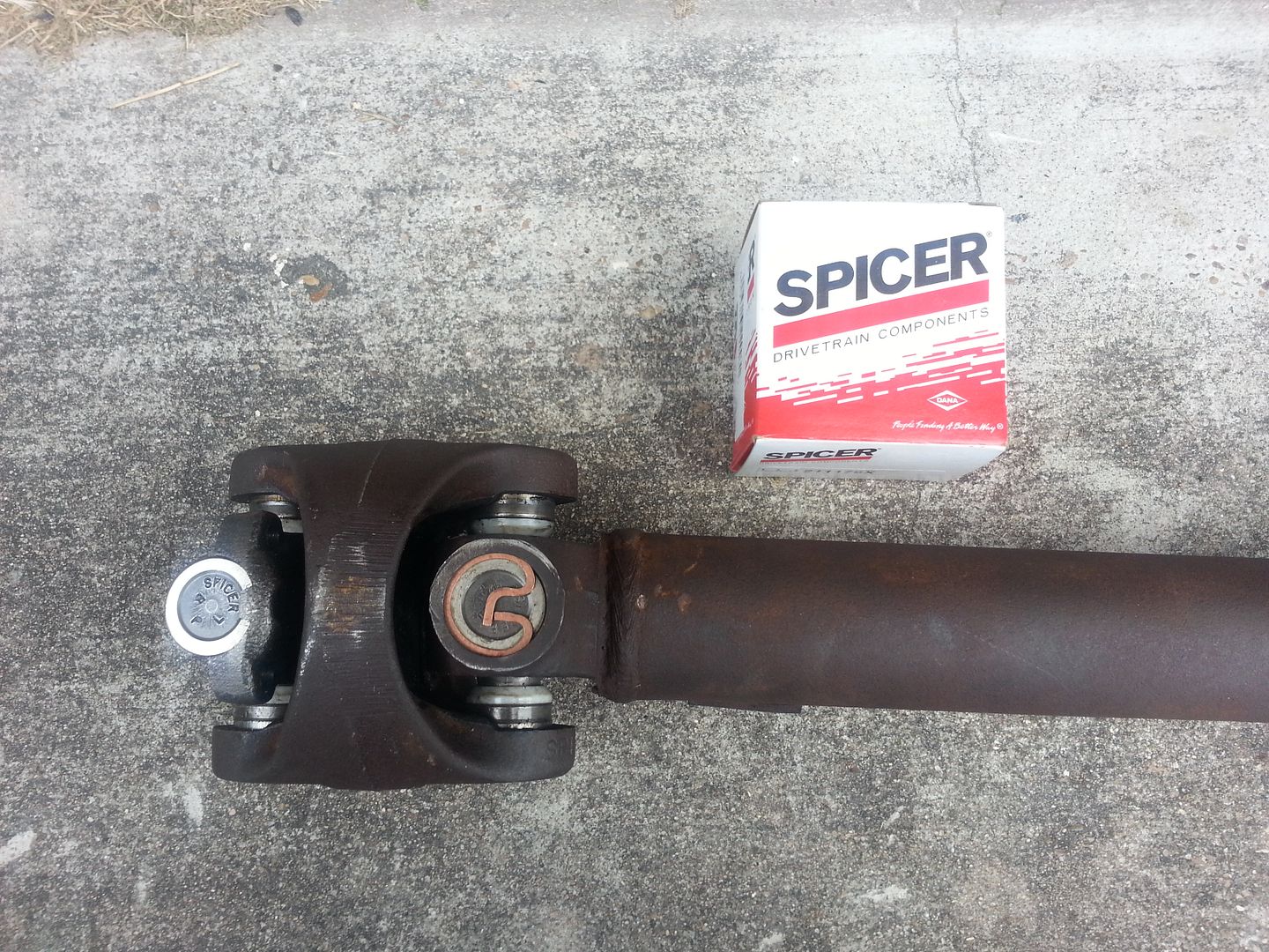

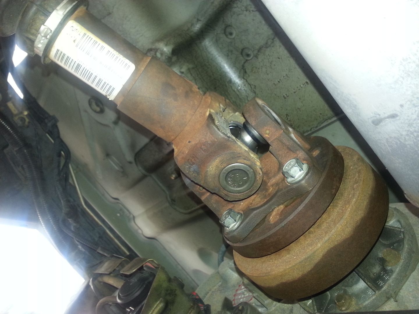

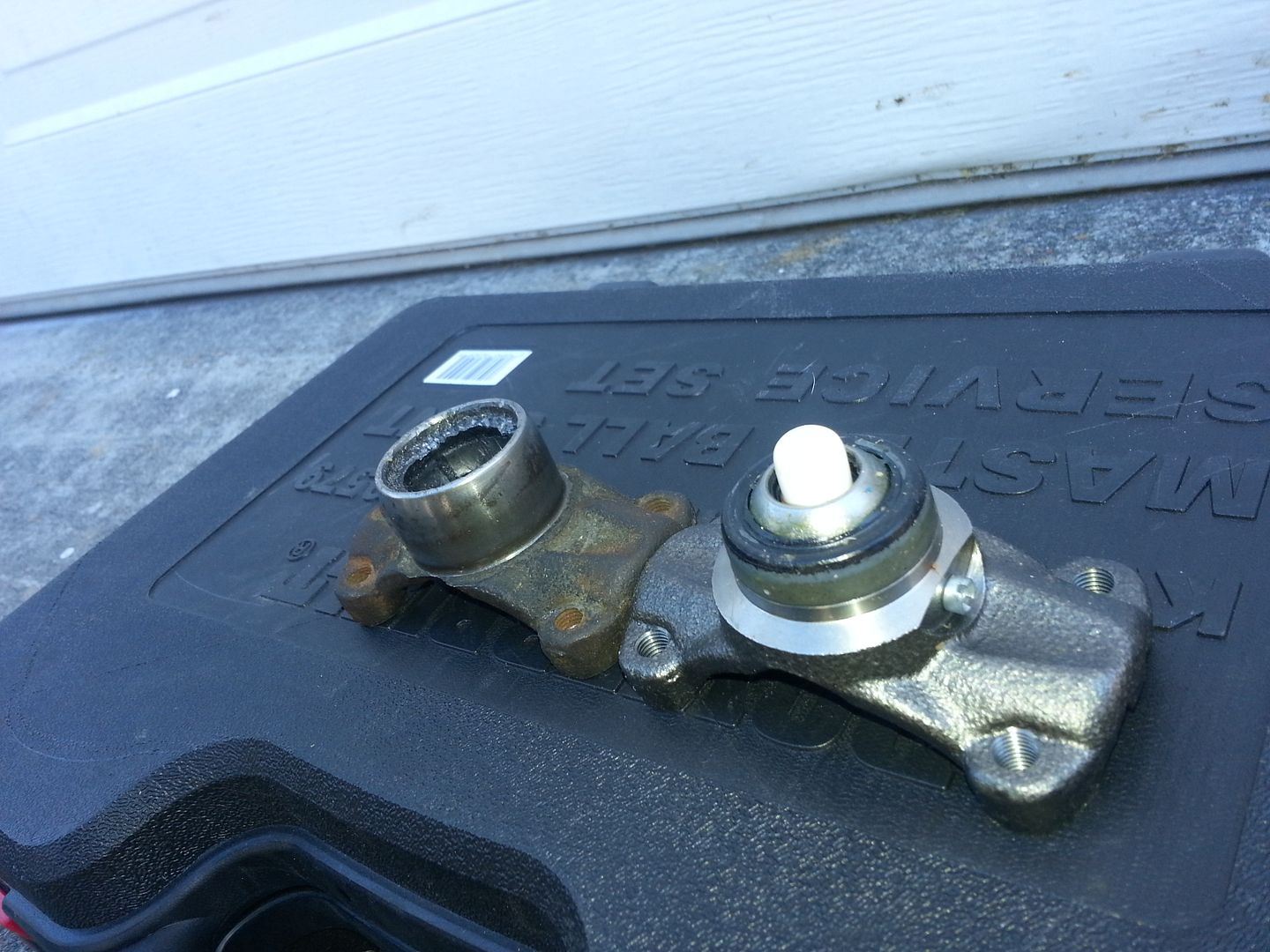

Rebuilt the front CV shaft with a greasable centering ball (a.k.a. socket yoke) as well as all new U-joints in both front and rear shafts. I liked the greasable socket yoke because it is reinforced where they taped it for the zert fitting. It also has a seal on top to retain the grease. As long as I keep up with regular greasings I should be fine.

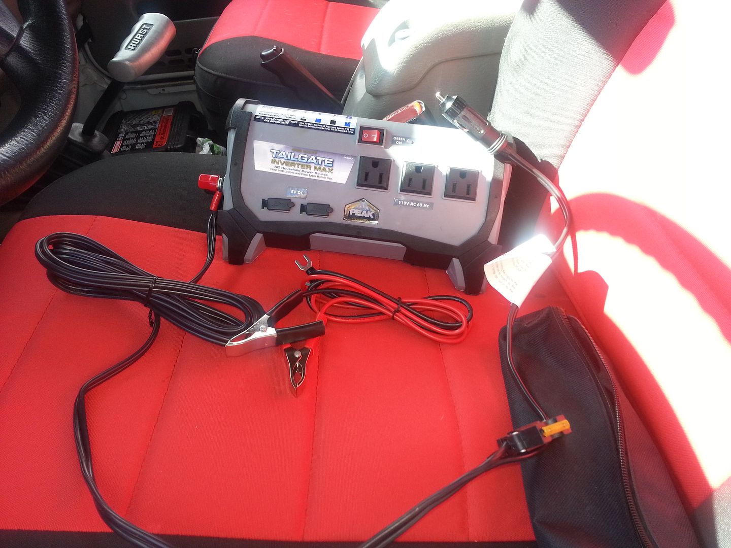

I also picked up this Peak 400 Watt power inverter for $30, it was $20 off.
