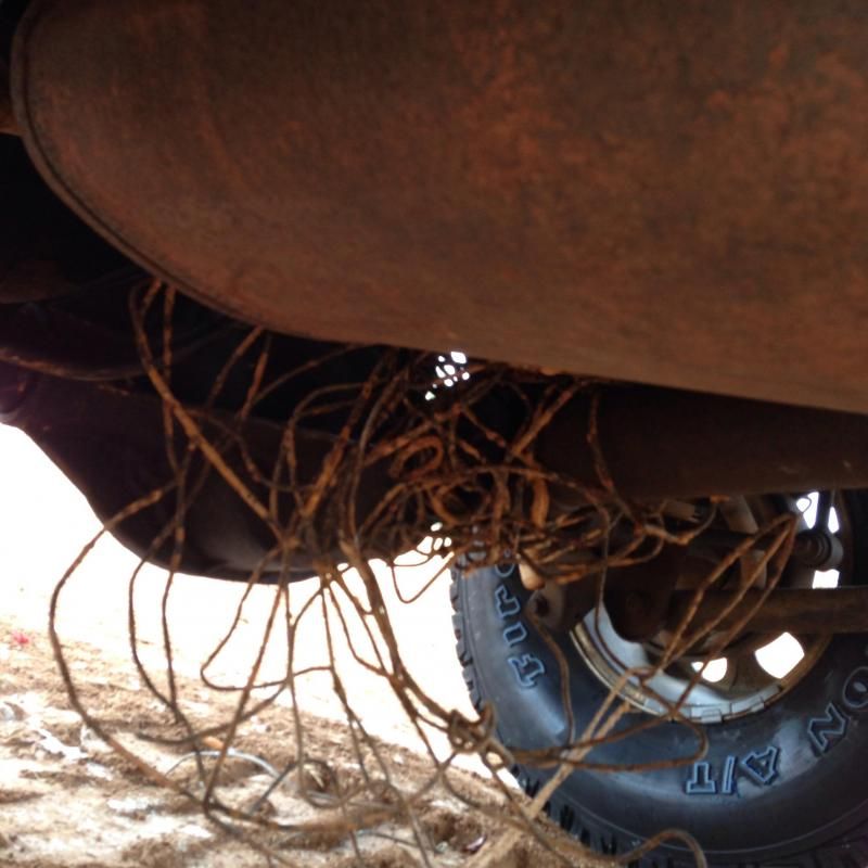

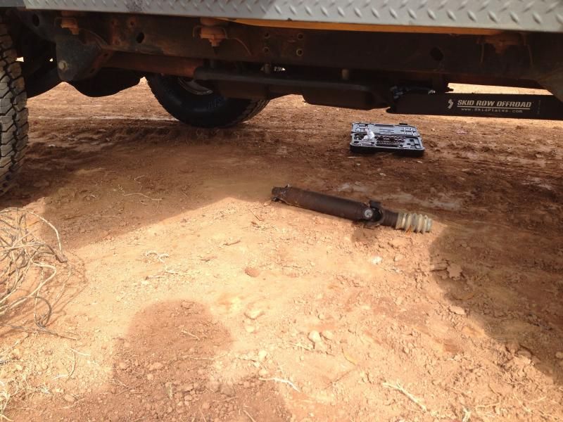

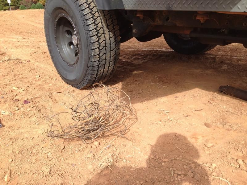

What a crap Saturday... Intended to drop the wife at work, swing by the Jobsite to snap some progress photos, then tackle her leaking tranny output seal. Got her to work, then swung in to the site. I snapped the pics and went to turn around. I start to hear something grind. Figuring it was just some scrub running along the skid I kept going. Well, about 10' it didn't stop, but got worse. I jump out and find this... That's 6x6 welded wire fabric. It's spun up around the shaft. If you don't know, that's used to reinforce concrete slabs, so not easy to cut. This being her jeep, all I had was the mechanic tool kit I insist she carry. After an hour I had made a hole big enough to get a socket in and pulled the driveshaft off. Another hour and I had worked the clump off... Got home and started to work on the seal. 2 of the six bolts holding the skid brook the nutserts loose and had to be cut off. I got all but 3 of the t-case to tranny bolts out and just couldn't get the last 3 loose no matter what I did. So, I lost all my daylight, and it looks like I'm gonna have to go find some new nutserts to replace the broken ones and reassemble it and drop it at the mechanic. I've gotta leave town in the morning and can't leave her stranded. Gotta love it... Sent from my TJ

Wow dude I have been there more than once. Barbed wire around my axle, I was able to untangle pretty easy. A wad of rusty chain link around my rear driveshaft/axle/diff, broke my TC output clean off.

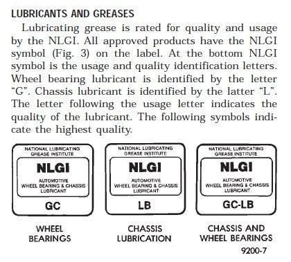

Put on some new wiper blades this morning. About to go out and grease everything. Anyone got some suggestions as to what I should use?
Best grease I would suggest is Mobil 1 synthetic grease. Look on the back of the grease tubes. You should see a symbol on the back like the pic below. Give's you a good idea of what to run with.
