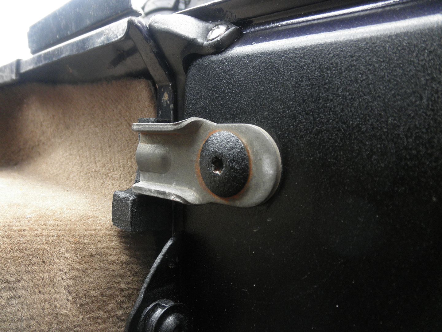

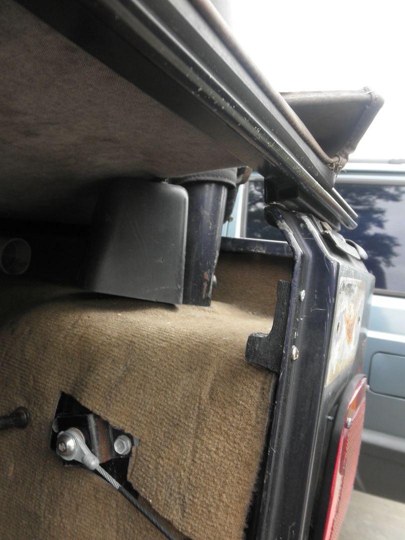

Since I was using the original latches I had to make brackets for them to go to so the gate would fit snug to the tub.
Latches are in the corners.
The L bracket was made out of UHMW. Got the idea from another thread on here.

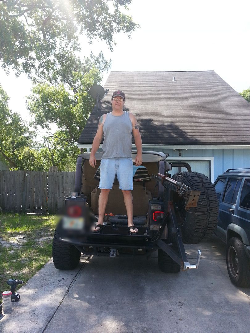

This is how it looks closed and latched

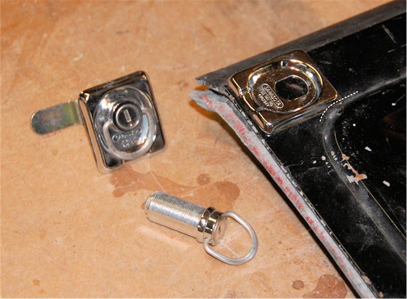

jscherb who has multiple threads on here showed these in his trailer build so you wont have to pull the cover to open the tailgate. I will be going to these or slam latches.
Slam latch
If I do the slam latch I will have to make an L bracket to go from the pin to the outside of the jeep between the gate and the deck cover to open. That will only be 4 screw holes in the tailgate. If I do the other latches I will have to drill a 3/4" hole thru it. Can't really decide which way to go right now.
I can tell you it is strong as hell.
