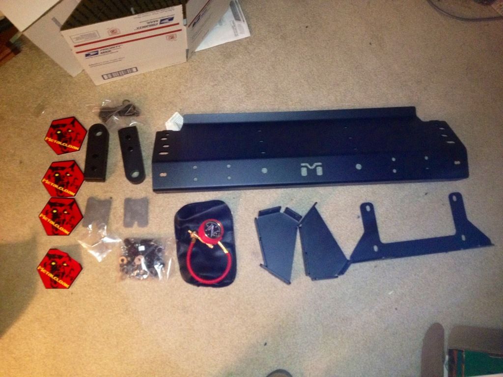

Took a 3 hour Amtrak ride, delayed 45 min, home to get my axle in time. Somebody fell off the train after one stop and EMS had to be called. But, $700 later, what a beauty she is!
Also finally got to see all my new purchases.

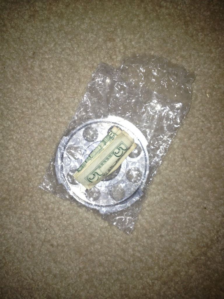

Got in the replacement tone ring from JB Conversions. Had a spot of rust on it but I'll let it slide. Way better than the last one. I was tickled when I saw that he paid my shipping by wrapping bills in the packaging.

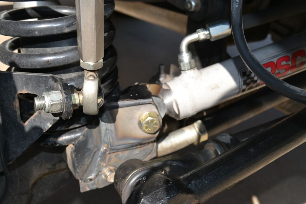

Not today, but I was able to have Blaine install the hydro assist on my rig yesterday. Took a bit of fabrication to get the ram to fit on my Currie hi9, but Blaine figured it out pretty quick.
Here's the gear box.
Reservoir tank and a mount Blaine made.
