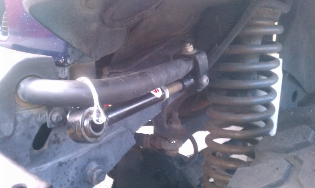

Originally Posted by chux72vette View Post
Thanx by the way as I like mine Built,,,not Bought and just different from the norm of everybody else that can mail order and bolt on.
You can get those at most Box Stores, Home Depot,Lowes, etc. Tractor Supply if you have one close or an Ace Hardware. I've had mine from other projects as they are military grade from tanks,,lol. Those are Grade 8 bolts in case ya might want to know as I didn't put that in there. After welding on the washers, I cleaned them up on the wire wheel which made them silverish and Shiny,,LOL. Let me know also if you need me to give any measurements on them but I bet you can wing it.
Thank you for the help. I've been searching for a way to move my JKS discos outta the way. I found round ones at Ace!
Careful. I had my sway bar links zip tied up like that. The whole sway bar swung down. My tire caught it and knocked it out of whack. Luckily it just spun the link at the bolt and didn't bend it, but I would suggest finding a way to support the whole bar.

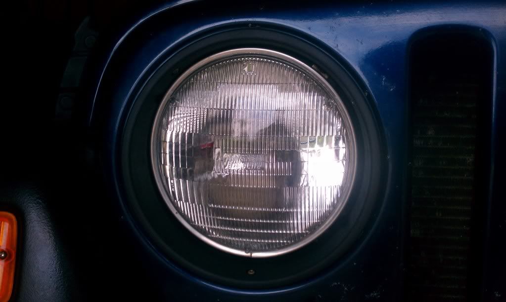

I hopped on the bandwagon today. The "chrome" foil was chipping and peeling anyway. Who knew conforming could look so good? Headlights look smaller now...
I am glad i took the 20 mins to do it... beats the crappy chrome.
