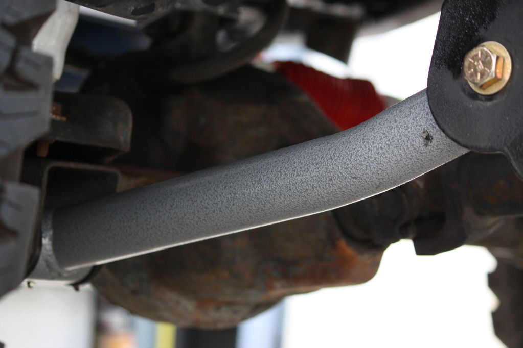

Originally Posted by piglife68TJ99 View Post
Finished the front upper and lower control arms this morning
Unless someone knows differently I think your lower control arms are backwards? The bent end goes towards the axle. The bend is to allow more clearance at full droop so the arm doesn't contact the shock mount.
And those poly bushings are gonna be hell on your mounts.
