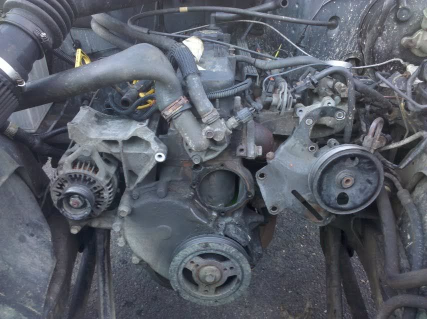

Blew my Head Gasket and waterpump =/
--snip--
Did you remove the water pump, or did the compression in the water jacket remove it for you?
What is the plan for repair? New head gasket? New JY engine? Reman engine?
No I swapped the waterpump out that was the pic before I put it in, if you zoom in you can see how the pully actually dug into in the block =/ the fan blade was as wobble as a tire during a death wobble. once I put everything back together the radiator fluid kept bubbling and the hose was too stiff even after the engine shut off which would mean the head gasket right? I'm just going to replace the head gasket can't really afford any other kind of engine =(
Bubbles in radiator typically not a good thing. Does it get hot real quick? Rent a "Coolant system pressure tester" (basically a radiator cap with little bicycle pump & guage attached) from Auto Zone..... this will allow you to pressurize the cooling system and possibly see where coolant is going. This past weekend I used this on a Jeep a buddy was looking at and coolant was squirting out of the head under the intake manifold. Wasn't a problem as we already figured the engine was toast as PO had been driving it while overheated.
