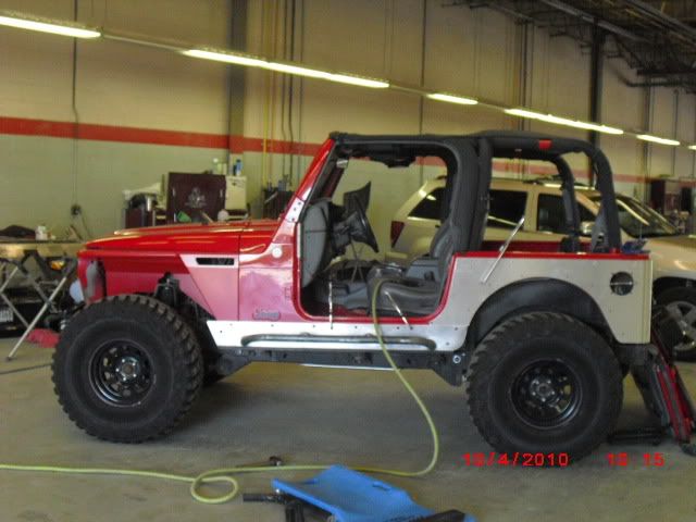

Today I cut holes in my frame and welded in the crush sleeves for my Nth degree long arm setup. I also cut half the stock control arm brackets off and cleaned up the factory welds.

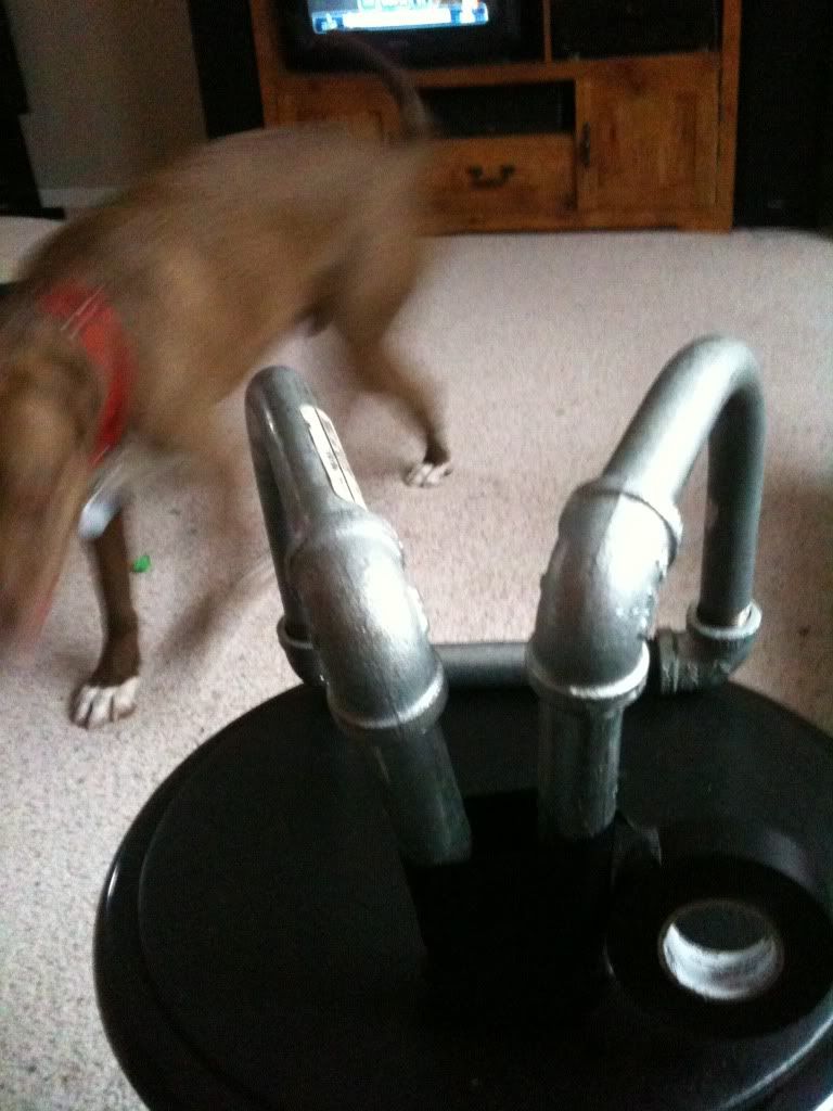

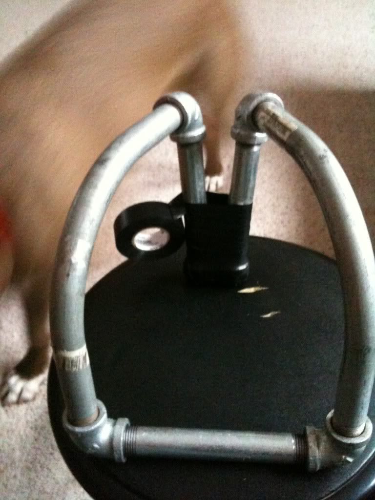

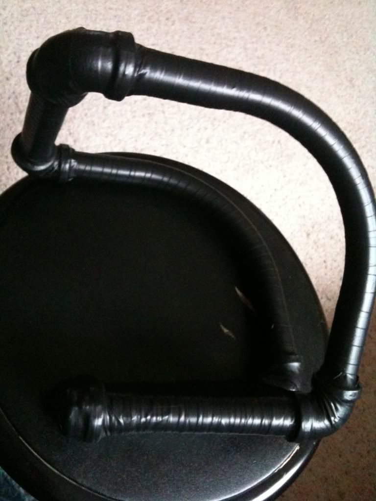

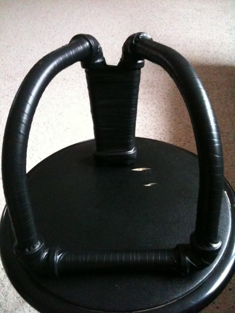

Here's the little detachable step I made for the wife. It slides in behind the tube on the rocker and sits against the body. She's been using it for about two weeks now and loves it. It slides under and to the side of the passenger seat when she's done with it. I made it for 20 bucks when I was bored at work. The corners are 90 degree galvanized elbows from the plumbing dept, as are the straight pieces. The straight pieces are 6" pipe nipples. The large radius bent piece is a piece of conduit from electrical, and I used two black pipe caps for the support legs. I welded the caps together, tightened everything with a pipewrench and vise, then covered it in black electrical tape so it doesn't jack up my paint any worse than it already is. Here's the pics.

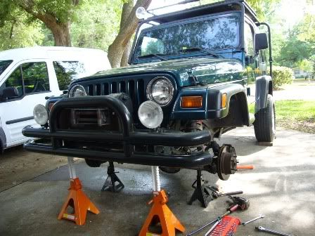

Backs done
RC LA Install
Now the front
