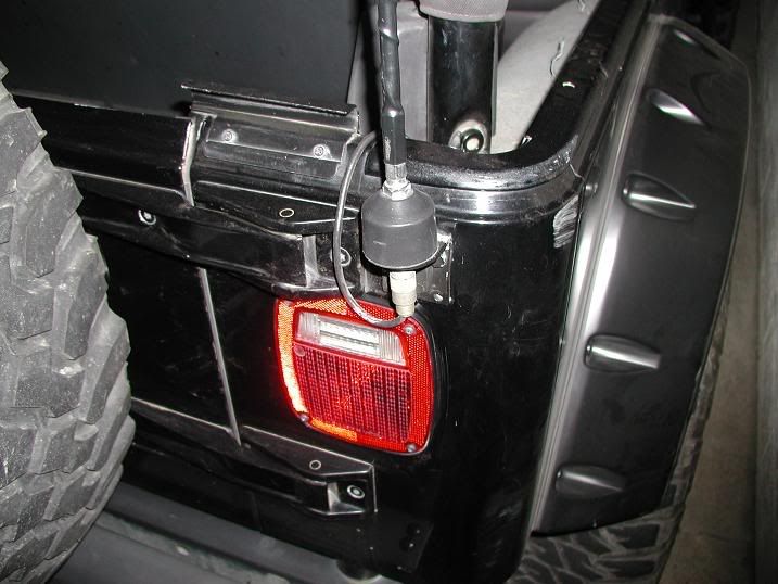

Here are a few pics:

Originally Posted by Omning
That looks really good. Have a write up anywhere?
Thanks. No, I didn't even think about doing a write-up for this. I just took the tail lights off, created a pattern to trace onto the tub, cut it out with a dremmel, trimmed the black knobs off of the back of the light (where the lens screws went), and plugged them back in and screwed them to the tub. Took me maybe a couple of hours or so all together...
If one was to do this, there are a couple of things to watch out for, like making sure that you go low enough when cutting the tub to miss the top of the wheel well, etc.
-Bob
Nice job.
Someone else did that and posted pics a while back.

Originally Posted by ncb76
Nice job.
Thanks. Hadn't seen it here on JF. A guy in my local club has done it, and I liked the way it turned out, so I went for it!
