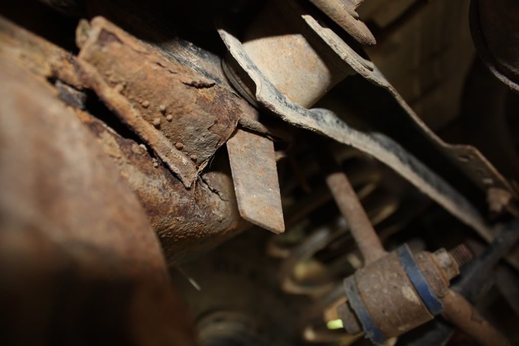

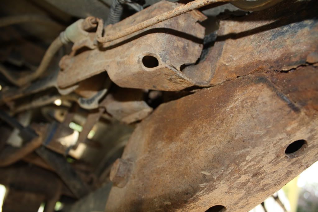

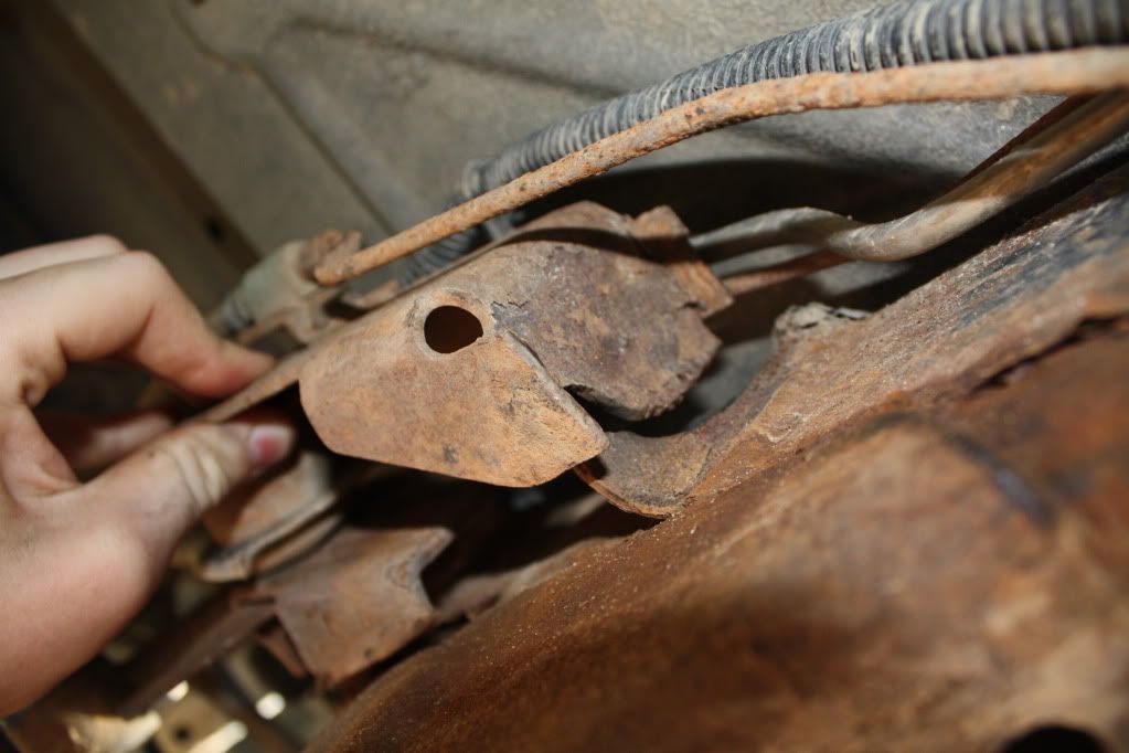

Definitely a big deal around MI / Great Lakes area. Heres what mine looked like ~3 weeks ago before i got it back from the shop. Looks a lot better now though
Any pics of the "after"?

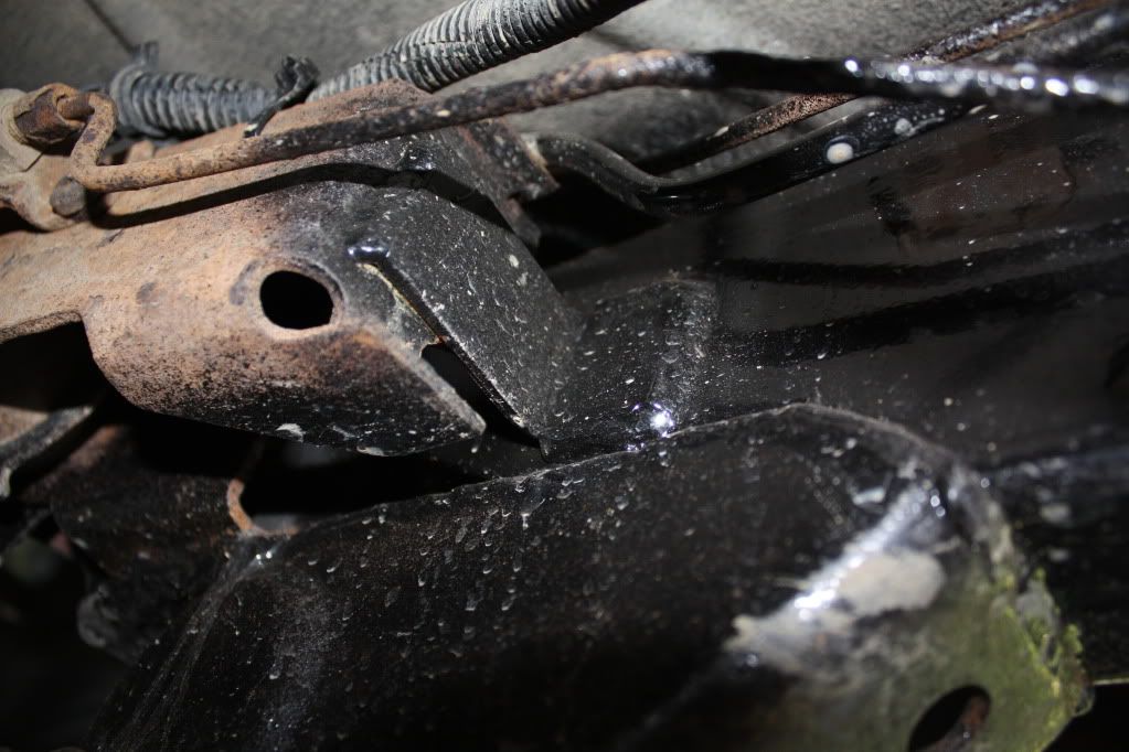

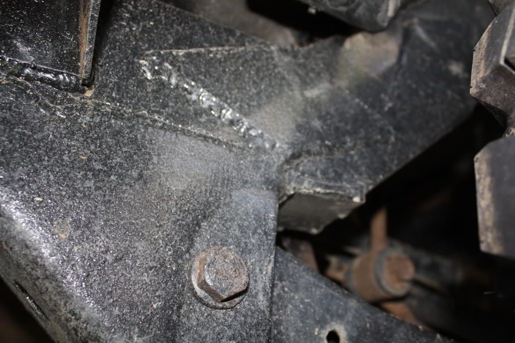

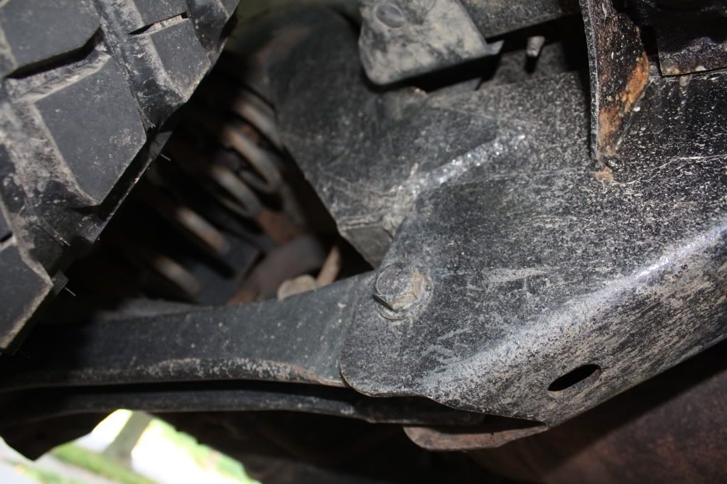

After pics
He cut out the infected section and welded in all new steel
The CA
Pass. side
I noticed today that, it looks like where he might have had the lift's "feet" placed was covered, therefore didnt get painted or something, and rust is already showing through. You can see the spot, right in front of the CA mount on either side.
Edit: sorry about the dirt
