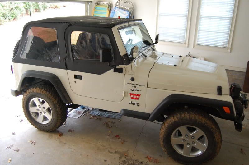

I think I have been eyeing this top ever since I got my Jeep in February, and I am extremely excited to finally own one. I bought it used for $400 in almost mint condition. I really really like this top compared to my factory soft top however it has a few drawbacks.
Things I like:
-HUGE windows (less fabric, more window)
-frameless design
-more quiet than my denim top
-converts to safari top easily and windows store in a bag in the top
-smaller blind spots
Problems:
-extremely tight fit, must install when its warm
-gap where it meets the windshield and door frame, will leak
-less headroom for passengers, I don't care I'm driving

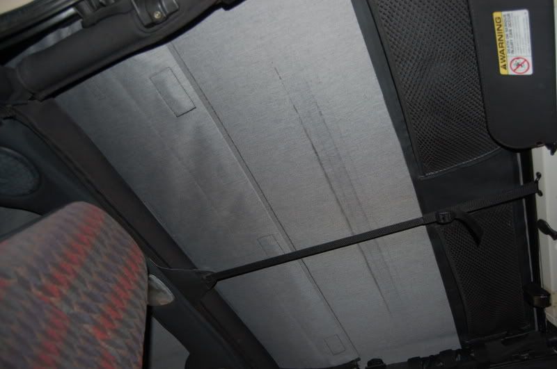

Inside pockets and strap that goes around the cage to pull the top tight, 2 great features

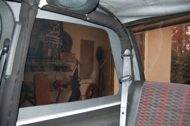

Decreased blind spots compared to OEM top

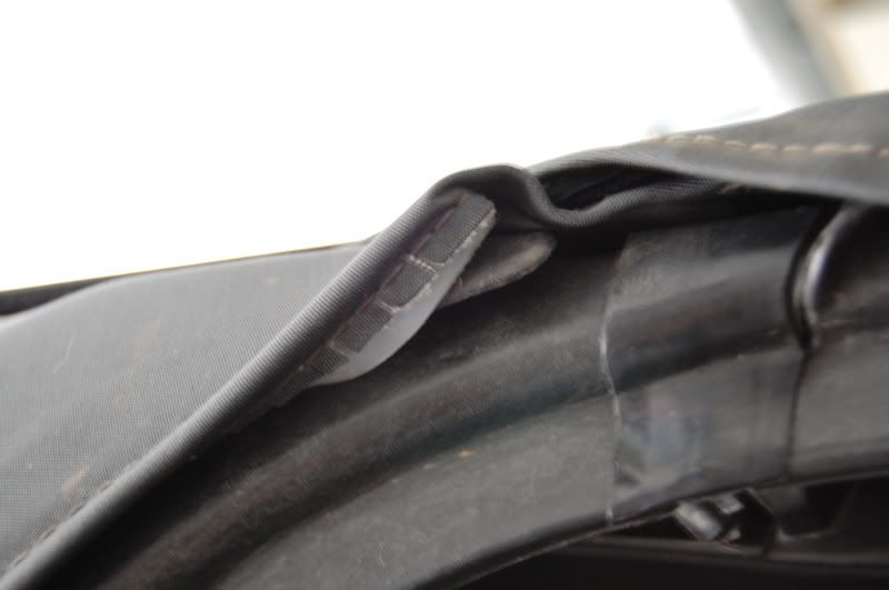

Gap where window meets door surround, the plastic lip doesn't want to stay in as well

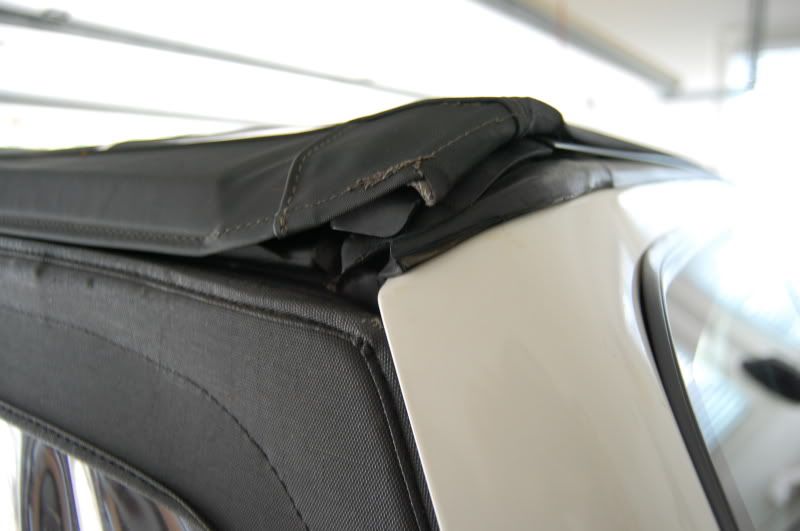

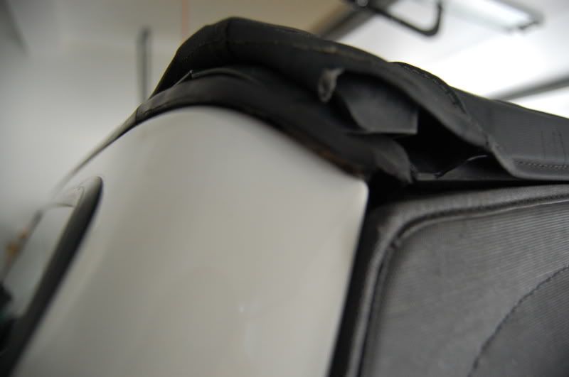

Corner doesn't want to roll into the header, also notice the large gap

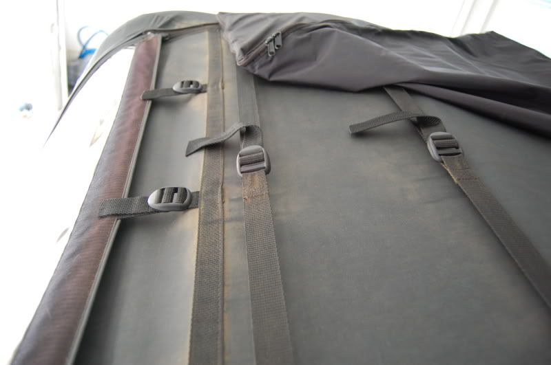

Window bag velcro'd into place, as well as width tightening straps and straps to attach the rear window

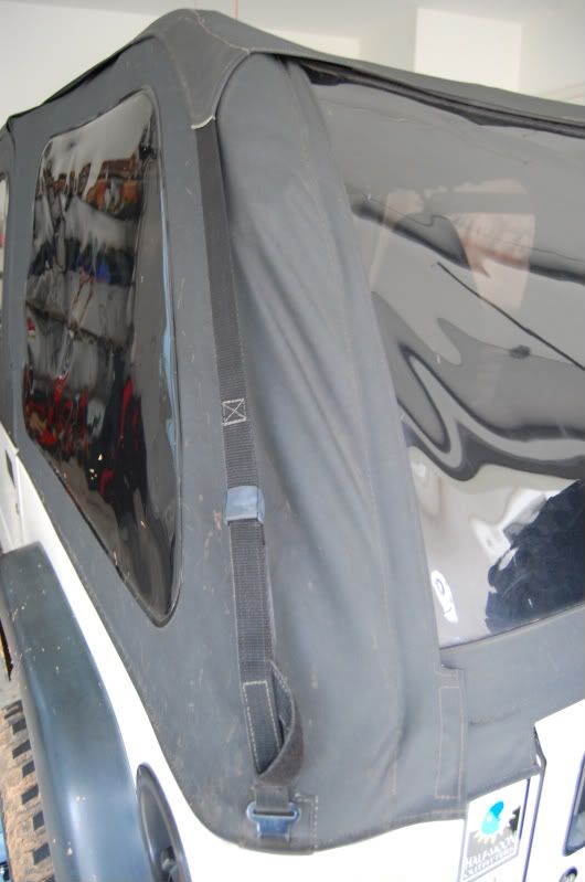

Side windows wrap around the bars to the top where they zip in
Right side corner won't go into the rail, maybe just my top. It is sewn through the plastic, and it prevents me from tucking it in.

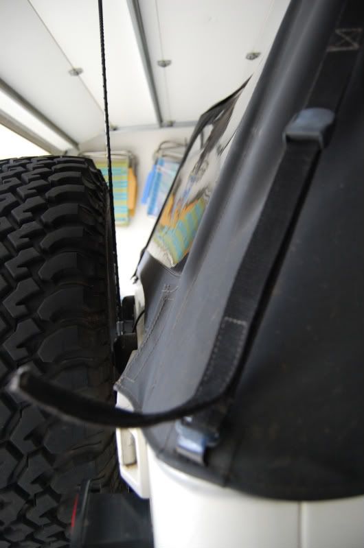

The straps are too long so I have to tuck them back behind. It's a nice system though because you can really tighten the top back with this, and this is what keeps it in place in safari mode.

The front header gap is caused by the bestop header bar, not at all to do with viking. Readjust the top a few times and those pesky corner deals should fit just fine. Nice write up and description.
I get a good amount of wind noise with my viking caused by the bestop header bar. In any case I like the top and am sure you will as well!

I've had my Viking top for about two years and I have had none of the problems mentioned above. The front fits very well into the header on mine and looking at the photos above, something doesn't actually look right with the way ThomasW's front is put into the header.
I also do not have any open gap where the window meets the door surround.

I've also had mine for 2+ years with no issues. All of the problems shown in the photos are easily fixed by properly adjusting the top.

I agree, and I fail to understand the fascination with these tops. I tried one out and I hated it. Luckily I found someone in my club to trade his factory top for it, and he couldn't be happier. So there are definitely people that love them, just like those that dislike them. I couldn't stand the way that cursed Bestop channel fit, the constant wind noise it produced (which was from using that header, no way around it), the loss of headroom everywhere especially the back, and the ill fitment. It fit tight around the roll bars and such, but as shown the window tips constantly try to pull out of the door surrounds, and the thing never fits up the same way twice after you pull the windows off. All those little gaps make wind noise.
