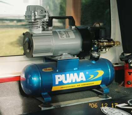

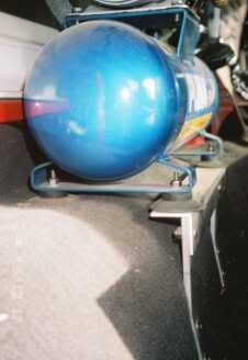

Puma works well...

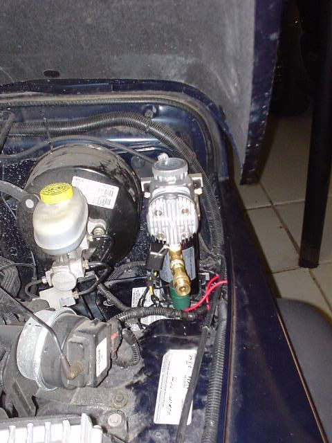

my compressor is just inside the hood in front of my brake master cylinder. This isn't an option for you b/c your EVAP can is there. Don't know if the viair can fit where the ABS tray is, but worth a shot. No issue with weatherproofing under the hood, I didn't do anything to it, and its been fine...

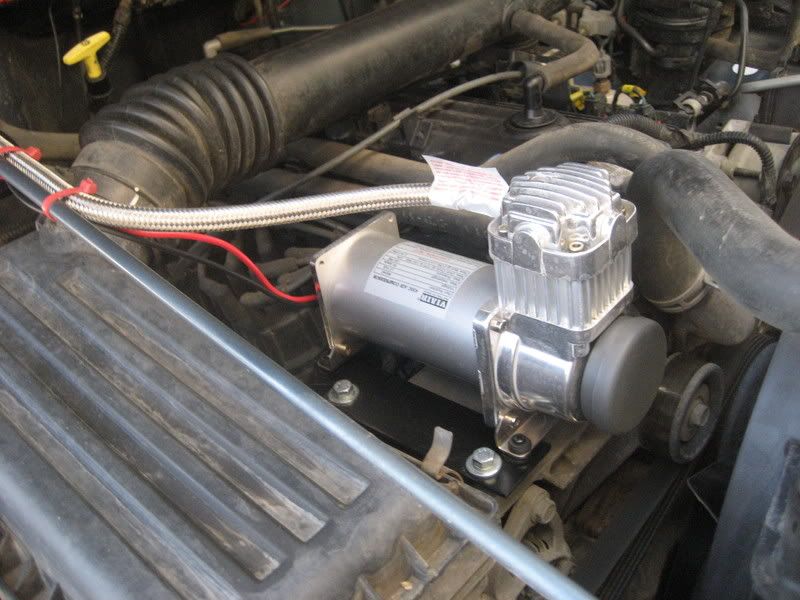

My 99 doesn't have AC, so I mounted the Viair compressor where the AC compressor would go using a couple mounts I fabbed up.
I mounted the tank underneath the driver's side.
