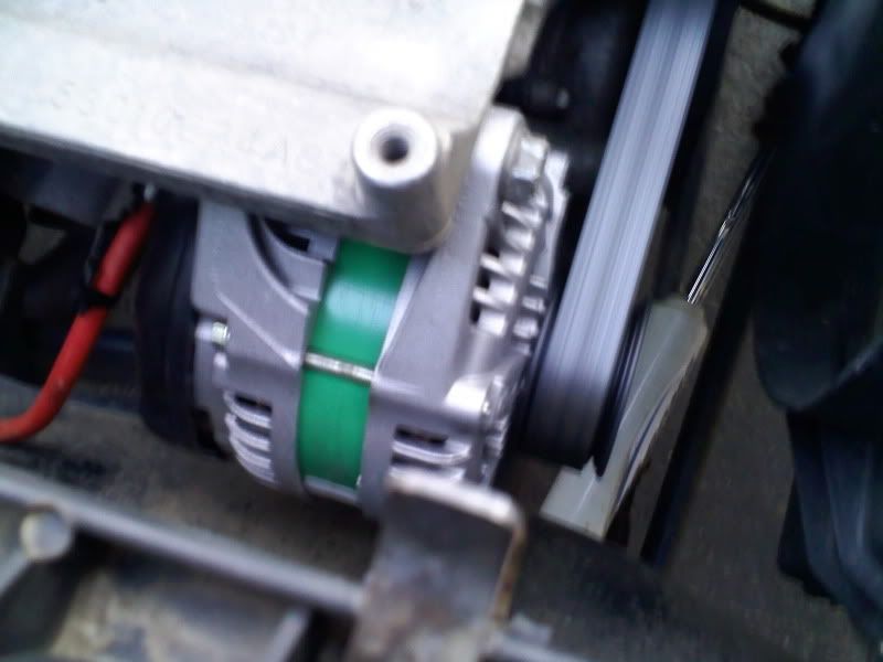

Today my Dad and I swapped alternators on our TJs. There have been several threads lately about this but there was a bit of confusion on the earlier models. We both used Duralast alternators that we bought at Autozone. They easily bolted on with no fitment issues.
For my 98 w/ 4.0 : Autozone part #13387 136amp, is a DIRECT FIT. No changes are needed. This is an option for 1998 Dodge truck/Durango w/ 5.9 V8. Price was $147.00
For A 2003 w/ 4.0 : Autozone part #12328 160amp, is a DIRECT FIT. No changes are needed. This is for a 2004 Dodge Durango w/ 4.7 V8. Price was $121.00.
As I mentioned, for a '98 and an '03, these were direct fits and a great upgrade for the money spent.
The one for the 136 would probably work for you, pretty sure the 160 will not.
