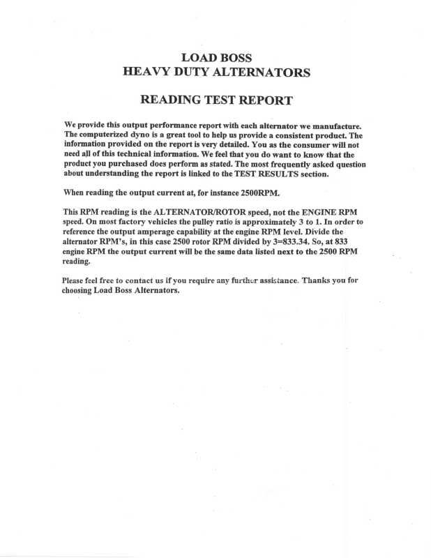

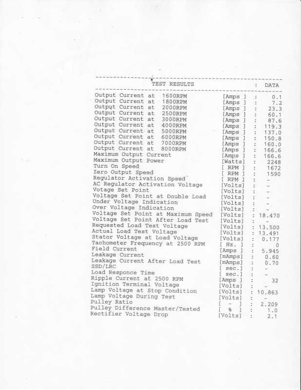

In answer to your Q, I would guess not. I am finding that at idle my HO alt doesn't put out much and I also have heavier cables as well as a High end battery, but as soon as my foot touches the gas pedal ever so slightly to raise the rpm, the headlights immediately go brighter. I think at idle they are just not designed to put out that much. When I bought my alt it came with a spec sheet to tell what amps it produces at what rpm. I will see if I can find it, I know I posted it somewhere!

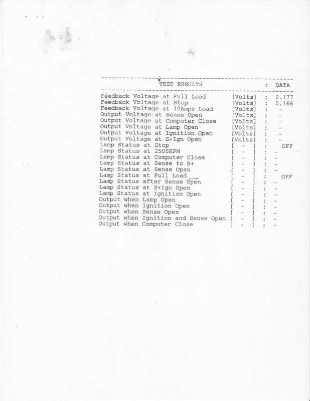

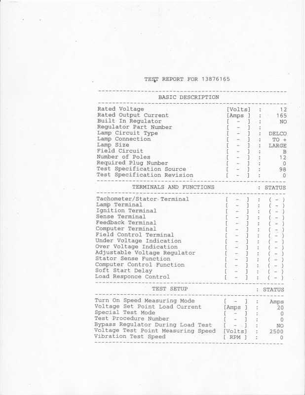

Read first sheet carefully:
These specs are for my alt. Not the durango one, but you can see how things change based on rpm. Like I said, My headlights brighten up significantly at the slightest rise in rpm. Good luck on your ventures.

Rich - good info, thanks a lot for posting that! Looks like the current output at engine idle speed is pretty much worthless.
So rather than looking into a different alternator, I suppose I should find a way to manually adjust/increase my idle speed....maybe by installing a hand throttle or something.

Yeah 23 amps or so at idle is weak, specially with the sound system and all the amps I am running. Good thing I dont run at idle much.
