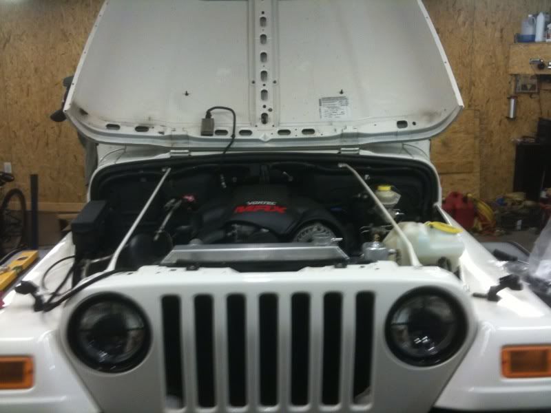

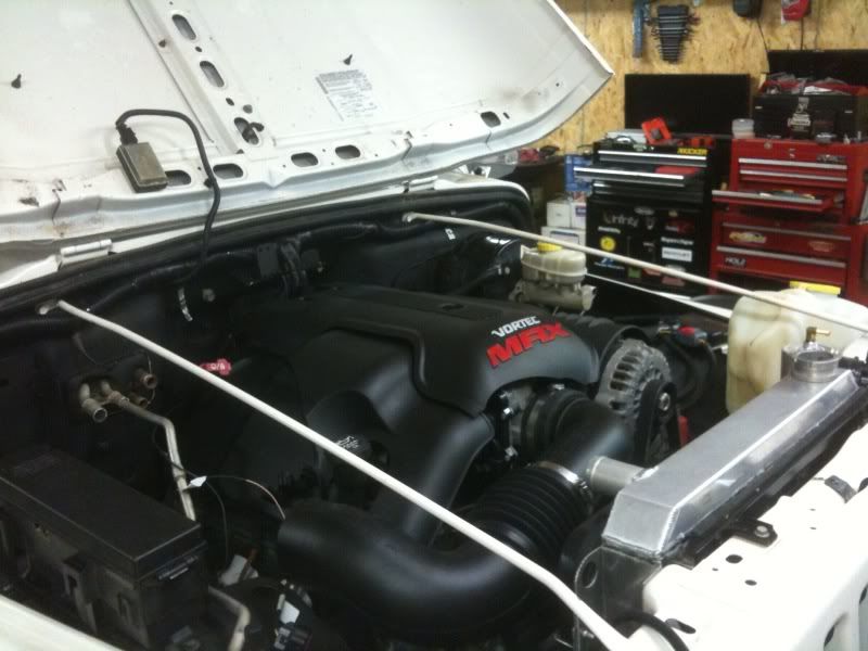

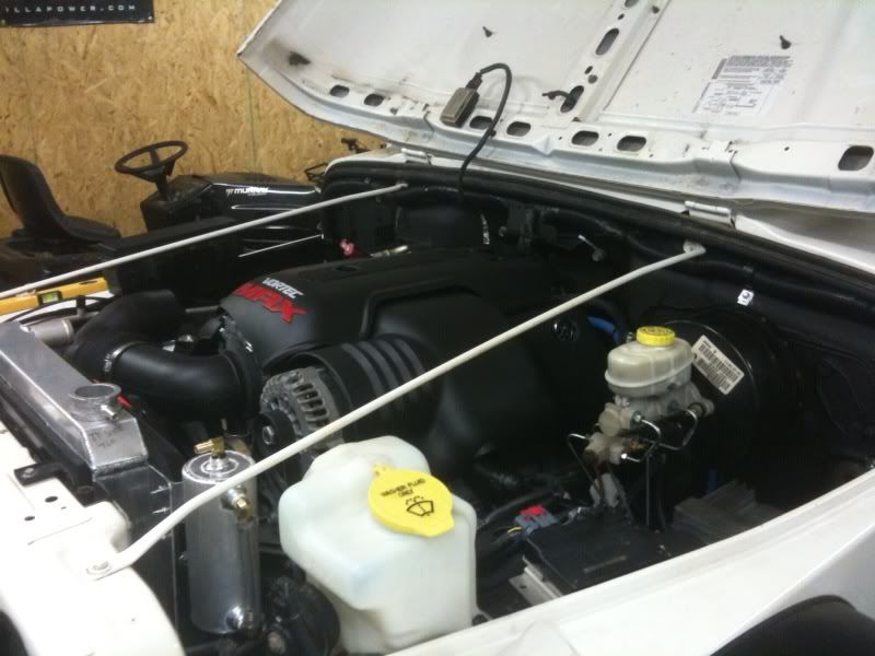

Just wanted to take some pics of the motor and tranny installed. Im now working on all the small things like hoses, intake, exhaust, exc. It should be done real soon.

That is really clean! Where can I find some more details on this? It looks awesome!

Ask me whatever you want. I started this as a winter project since I cant be doing things outside in the cold.
I have done tons of research on jeep forums, truck forums, ls1 forums, and more. I followed up on alot of other swaps people have done and wanted to make mine look more like it come from the factory than just a swap. I have alot of hours in this swap so far to make the powerplant looks like its at home under the Jeeps hood.
So far, I am very proud of my work.

You should be very proud. That looks awesome!
What is the engine and tranny? What's it from? How well did it match up to the Jeep? Can you post some pics from the underside to see the fit and clearance? What kind of adapting have you had to do?

The engine and tranny is a 6.0L/4L65E combo out of a 2006 GMC V-Max. The swap is not very difficult if you have the right tools. The advance adapters motor mounts weld to the frame after you remove the original mounts. I had to notch the passenger side frame a bit to make room for the a/c compressor. If you dont want a/c, you will not have to do this.
Also you will need a transfer case adapter. I got mine from advance too and it comes with the vss sensor for a speed signal. The tranny mount came from advance as well, but make sure you get the powerglide mount. Its a more heavy duty mount.
I will be using the stock gear selector, so I was able to find a cable kit that works great and the gating is right on.
Ill get some pics of the underside later today for you.
