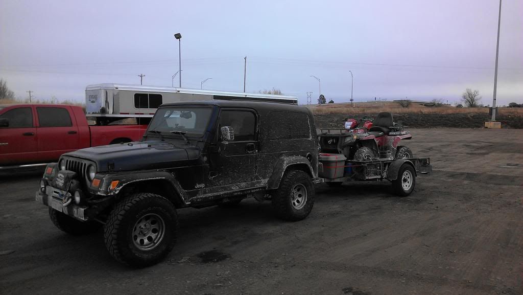

very happy with the spring choice overall. For the holidays, I actually drove the Jeep essentially empty for 1300 miles then turned around and drove it fully loaded back to Colorado, for a total of 2600+ miles. Several hundred pounds of crap in back of the Jeep, with an 1800 lb trailer in tow. The airbags and OME 949 rear springs really handled the load well. No trailer brakes here, so the Vancos were getting a work out.
One of the rear shocks is getting weak, but that's because it has a big baseball size dent in it from when my exhaust got mangled in the rocks. I've planned to relocate the rear shocks, but it's low on the list and other stuff has been taking precedence.
For those of you that don't live in the salted road areas...imagine driving on a dusty dirt road at 70mph. Visualize the dust, now replace it with salt that eats metal. Welcome to the midwest and why vehicles rust out so fast.
This was one day on the highway:
and yes, that's a new-to-me inherited toy....well used, but in good shape, Polaris 500 EFI Touring ATV....for hunting & more adventures to come
