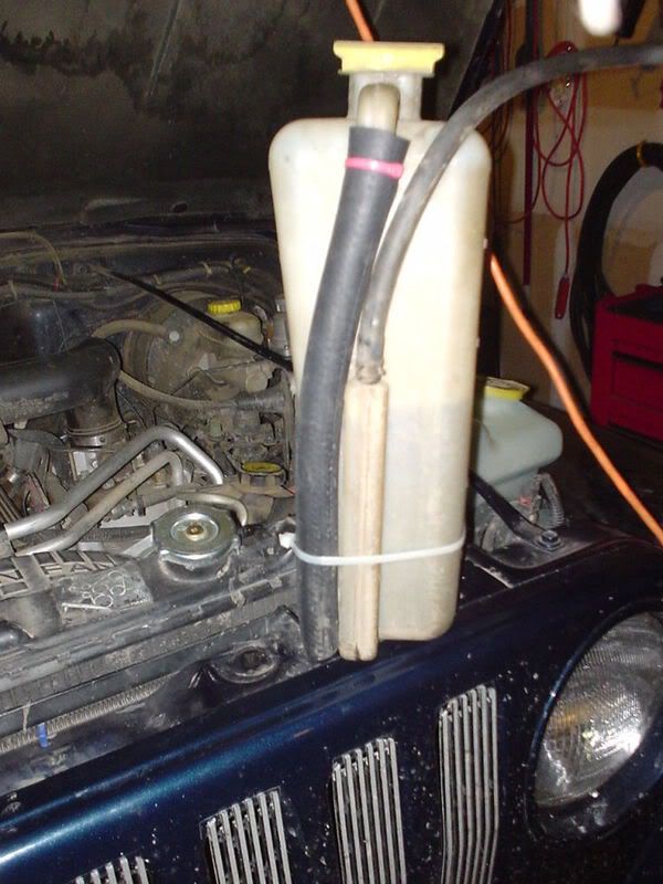

Finally got tired of the overflow coolant spraying the entire inside of the engine compartment....
Easy fix, just finally got around to getting the stuff. 1 ft of 3/4" heater hose + zip ties.
now the overflow goes below the engine compartment, and the bottle still goes in and out same as stock.
Next up: I'll be changing my tranny cooler setup. I had things all piped backwards. for those paying attention to 42RLE tranny coolers see here: http://www.jeepforum.com/forum/f9/ke...l#post12173429

That's a very good idea for the coolant overflow; it would be nice to have the overflow go under the engine compartment. I might do that...
Did that many years ago, works well...
TSB Information: http://www.automd.com/tsb/jeep_m/wrangler_mm/2000_y/
I remember seeing that picture I keep stealing mods from you
Did you hook your aux tranny cooler to the hot output side line or the cool return line? What's the flow path of your dual coolers? similar to the picture above, or different?
