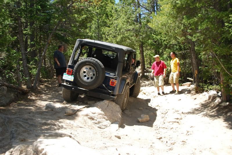

Did some wheeling today and destroyed my exhaust. This was on Ironclads/Plane Crash, I tried to take a harder line and really screwed myself.
Ended up stuck between here:
and here:
this was the result:
It's also pretzeled bad on the bend over the axle...almost kinked totally flat. Which the engine doesn't seem too happy about . It's smashing into the tub & shock and both exhaust hangers are bent up bad. We had to use a winch to pull it out and up to the frame enough so I could finish the trail. The tailpipe is held on by speaker wire at the moment.
But when I got back, I found a Dynomax 2.5" exhaust for an LJ on craigslist for $35 . It's missing clamps, a hanger and the intermediate pipe, but its a start to a fix
You'll also notice the new Bestop Tire Carrier...which is freakin' sweet btw. I shoulda went that way the first time around. Their hardware blows, I had to replace most of it, and the rest I had to chase with a die, but once its setup and adjusted the tailgate slides effortlessly and the tire is very sturdy.
