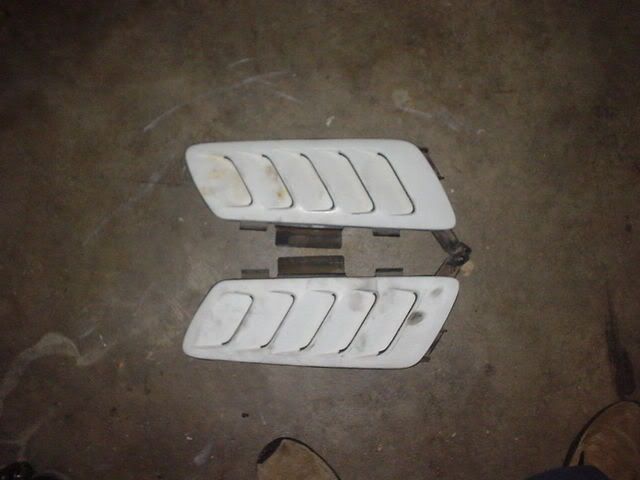

Scored big at the junkyard too:
^^1st gen Grand Prix GTP hood louvers...anyone remember the Oman4x4 write up?

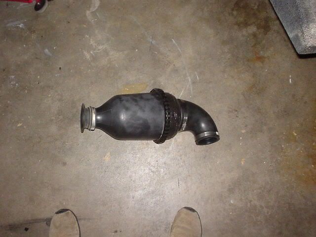

^^windstar airbox cut down, JB welded together, caulked for sealing, and elbow and reducer from Intake Hoses, IntakeTubing, and Intake Clamps
