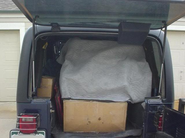

Tested the AirLift bags too.
Normal ride height (21"):
Moving time:
Firewood on the back:
Sagged 3":
Got an inch back with 20psi:
It drove and rode sooo much better with the bags inflated. Much more stable with the heavy load.

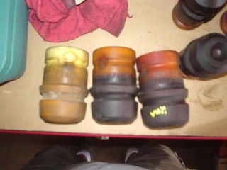

After some careful testing off-road and on-road with the Airlift bags, I decided I needed to adjust the bumpstops. I discovered they didnt allow the jounce bumper to be compressed all the way, and with some air in them, the AirBags can't compress entirely themselves, so i was loosing a bit of rear axle articulation. problem being was the jounce bumper was constantly depressed 1/2" into the airbags.
so i went junkyard hunting...found that ZJ front's use the same jounce bumper and cup the TJ does in the rear. So i grabbed 2 sets of bumpstops from ZJ and XJ fronts for testing (8 total). Thats a crapload of bumpstops.
Stock bumpstop on the left, ZJ #1 in the middle, and ZJ #2 on the right.
The middle one and the TJ one actually have the same part number on them. The ZJ #1 and #2 are different part numbers and actually different impact head design, but not a significant difference.
eyeballed the distance to be removed, and used a wood saw to hacked em down:
still enough to keep the bumpstop cup off the airbags too.
now the airbags fit properly, maybe 3/8" space there, unloaded with 1/2 tank.
