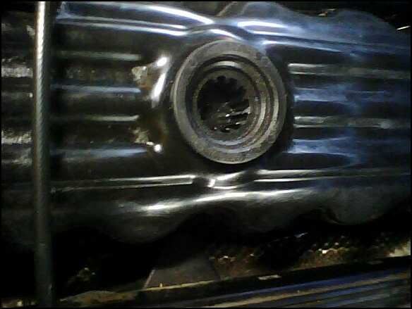

regular maintenance turned into a disaster
Oil cap plastic guts exploded-
This is stuck in the valve cover-
Picked up a new cap from the dealership....something so simple turns into a mess.
Not my day today...gonna stay away from all tools and mechanical instruments.
mine got stuck on, had to pry it off. after that i super glued the crap out of it. no more ratching oil cap
i don't understand why there is even a ratchet mechanism in the oil cap...what critical purpose could it serve? Wouldn't it be cheaper and easier just to write on the cap - do not overtorque?
Unlimited04 is offline   Reply With Quote

Mine has been like that since I got my jeep...I just use channel locks to get it off/on.

I used an oil filter wrench on mine when it did that. I have one that's a rubber strap and was able to grab that little piece and twist it loose. I then put the two pieces back together and have been ok ever since. I guess I need to get a spare cap for the time it decides to blow up in my hand

It was no problem for channel locks and the new cap is on....its just one of those Jeep things that makes me wonder WTF the engineers were thinking....
I could never design vehicles. They would be entirely too function, too reliable, too easy to work on yourself and would simply make too much sense.

the next time the Jeep Engineers have a Q&A on Jeep Forum, we have to ask them why the engine oil filler cap has a ratcheting mechanism. What were they thinking???

Remember, especially with vehicles, engineers have to assume that their average consumer isn't going to know diddly-squat about automobiles (even something as simple as an oil filler cap). If they were to do as you say and put a "DO NOT OVER-TORQUE" label on the cap, some dumb blonde would go and break it and sue Jeep claiming "over-torque" was a technical term she shouldn't need to understand.
The real question we should be asking is why did they make a ratcheting mechanism that breaks so easily. Personally, I couldn't give two ****s if it's ratcheting... just so long as it works
haha my old TJ did that every time i would try to change the oil when the engine is hot so i used to start every oil change with a channel lock in hand..
i would pry the top of the stupid ratcheting cap off and turn the underneath part with the channel lock.. became part of the oil change
oh and about the jeep engineers thingy i guess we can put that on the list of stupid design ideas like torx bolts and 42RLE behind the 4.0..lol
