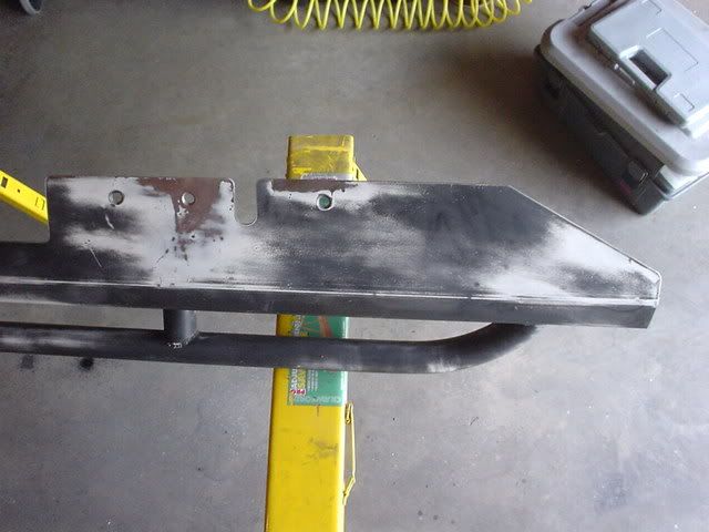

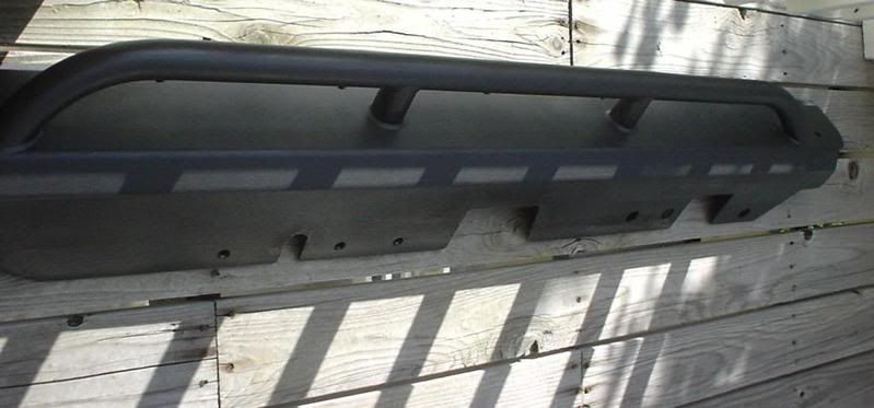

Rokmen rock sliders underway - got em used for a good price. No idea how 'used' rockers come to be, but whatever I saved a ton of money since I got everything- rocker gaskets, internal reinforcement braces, all hardware and the sliders. There was a few scratches on the passenger side, but other than that they were in good shape. I had a set of aluminum BDO's originally, then decided I didn't want to go with aluminum and drill through the body, so I traded those off, then got a set of Garvin frame mounted rock sliders, but decided I wanted body mounted steel for more complete protection...so basically I've been very indecisive. Finally settled on Rokmen's after seeing a friends rig and meeting the Rokmen guys.
So I sanded them down with fine grit sandpaper - cleaned all rust, loose paint and sealant off.
Primed with this stuff, and lightly sanded again to ensure a smooth surface.

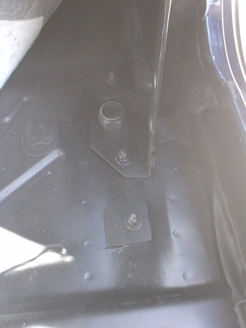

About herniated myself doing a test fit today. Found out I've got interference with the PSC roll cage bolt that goes through the floor and the rock sliders. I couldn't get the sliders in place without a better floor jack and more wood, so I've got to look at my friends rig and how his mount. I'd prefer to tie to slides into the cage, but I may just end up grinding out a section to clear the bolt. Theres already a slot in the slider for drainage, but its not near big enough to clear the bolt, and I can't even tell if it lines up right. The PSC cage bolt is like 1", so this isn't going to be much fun. I don't even know if my drill could torque through 1" of steel, even if I had the right bit. The rockers fit around my Kilby body clamz, but it will make install a bit more complicated, just more wiggling.

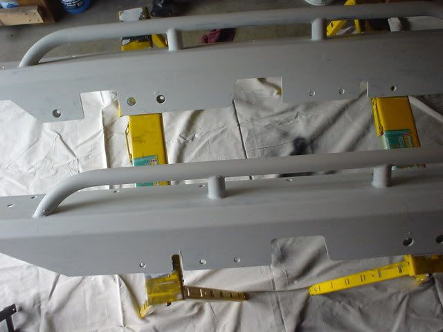

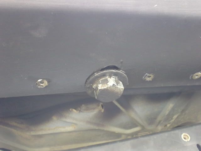

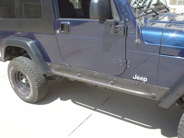

I got the Rokmen sliders finished - 2 coats of primer, 3 coats of semi-gloss black, 2 coats of black Hammered finish, 2 coats of Clearcoat. Opened the drain slot up a bit with a grinder so I can tie them into the PSC cage. I plan to install them next weekend.
The quality on these Rokmen's is amazing. Its hard to explain till you see them in person, the welds are literally perfect, the fit is awesome and the bare metal itself is extremely clean.

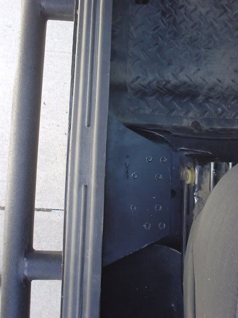

Got the sliders on:

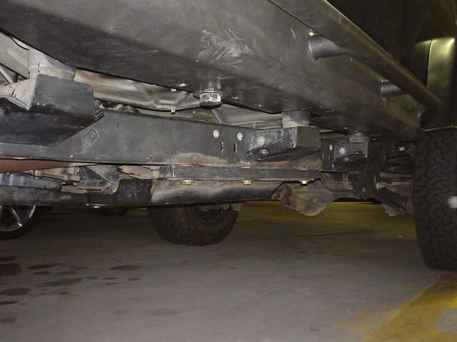

Full coverage with the Kilby body mount skids:
Internal Reinforcements
Tied into the roll cage with one 5/16" bolt and one 1" bolt.
Theres a 1/16" rubber gasket against the mounting surface (held on with construction adhesive), a rubber door gasket around the lip, one tube of silicon caulk and one can of undercoating in there to keep rust at bay.
I put grip tape on the bars to use as a step - that didn't even last 12 hours. Horrible idea. I ripped them off this morning after removing a chunk of skin from my leg like I had a fight with a belt sander.
The paint is black "Hammered" finish, the internal black paint is rattle can "Plasti-Coat". It did a sweet job on my battery tray, so I figured I'd give it a shot on the floor.

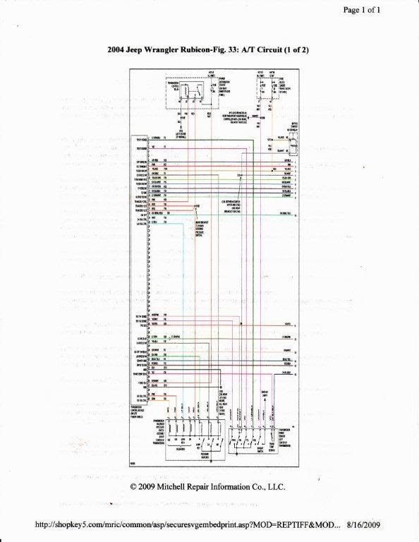

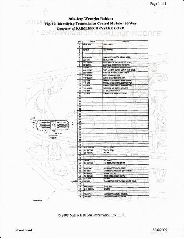

are you still messing with a trans temp gadge that will run off the tranny's thermistor?
here's some stuff I ran across while doing some diagnostics on a 42rle...
the thermistor puts out 1.8 v at 100 degrees..
the violet wire at t54 on the TCM is the temp wire.
I want your factory 07-up take-off/thrown out JK front/rear Lower Control Arms! Bent ones are perfect also as long as the bushings and cold cut rings are in good shape/useable

o0o nice mudb8.
I've also got the two stage voltage graph from the 42RLE's temp sensor (in the FSM), which i forwarded to Scangauge some time back. They got back to me, and while the graph shows what voltage = what temp, it doesn't specify where in the PCM/TCM that data is stored, which is whats needed access it from the X-Gauge. They claim they're working on it tho. I'll forward those pages and see if that helps.
I'd love to get a temp gauge into the Scangauge...my dash is cluttered enough as it is with CB, GPS, radar detector, Scangauge, cell phone, iPod, roll cage, kitchen sink, etc...

o0o nice mudb8.
I'd like to believe ya could tap into the t54 wire that comes from the thermistor to a gauge that's compatible with the voltage.... haven't messed with much of that stuff tho..
yea, you probably could, but you'd need a gauge that understands the voltage. The 42RLE has a two stage sensor, so its linear in two sections with varying voltage across both spectrums.
The X-Guage is hopefully the ticket tho - digital programming
