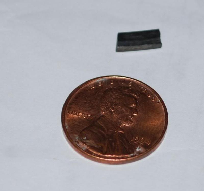

They found a piece of a snap ring and lots of metal fillings stuck to the magnet. Lots of brass shavings in the fluid. Took it to the dealership with the piece of the snap ring and this info, looks like I need a trans rebuild or possibly an entirely new trans. I'll know more Wednesday when the stealership gets the trans disassembled. To top it off, since the Chrysler factories have been shut down, there is a huge parts shortage and I might not have a Jeep for a week or more...waiting for parts. Welp, the powertrain warranty should pay for itself with this one.
The trans shifts fine and I see no signs of slippage, service manager at the dealership said the TCM likely compensated for the damage by increasing the line pressure to keep slippage minimized.

send or post a pic for me... there aren't any snap rings in there that would end up in the pan and still allow the trans to opererate. metal filings are completely normal... the size of them is what matters. I've built so many of those things, I could prolly tell you where it came from. it's most likely a sealing ring.
turn the key to the on position, turn the headlights on, then off, along with turning off the key.... that resets the computer and will have to relearn your driving habitts..

I don't know if I can get a pic of it, its real small. Its only about twice the size of an eraser head. Its magnetic obviously, has a slight curvature to it, maybe 1-2mm thick by 1-2mm width. Definitely a piece of something thats larger in diameter.
I know metal filings are normal, but apparently this was a large amount - more than normal. Also theres lots of brass shavings in the fluid. All this probably indicating the clutches are toast or close to it, according to the dealership & the local shop.
I talked with the service manager at the stealership at length, its only going to cost me the deductible of the powertrain warranty, and they will at least rebuild my trans. I may get an entirely new (remaned by Chrysler) trans if the rebuild cost is over 70% of the cost of the new trans. Either way, I get a 3 yr / 100k warranty. So as long as the parts supply for the 42RLE isn't completely dry, I should get my Jeep back in a week or so...just in time to drive across the country for a big fishing trip I have planned.

i'm amazed at my Nikon's macro setting
I did see the sparkly brass in the fluid in the pan, and I did see quite a bit of metal stuck to the magnet - it looked like a handful of sand.

mudb8, any idea wtf that piece is? I'm taking this POS trans in tomorrow to be fixed/rebuilt/replaced.
