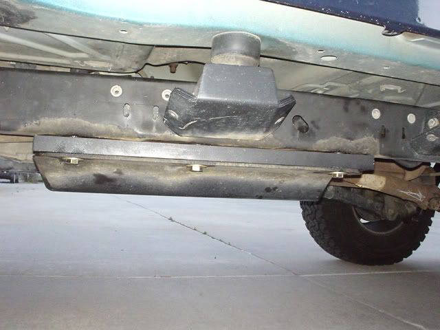

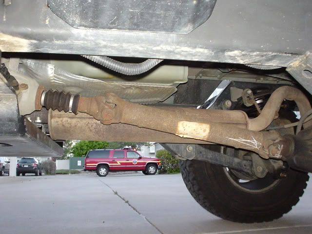

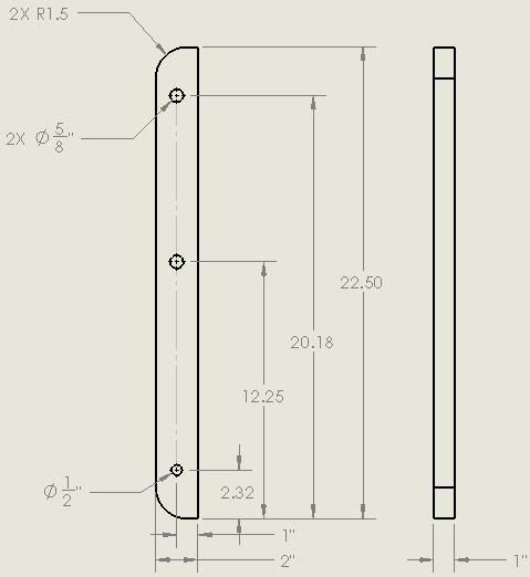

Homemade T-case drop -
Material: 6061-T611 solid 1" x 2" aluminum <--use T6 or better only!!!
I didn't radius the edges like shown in the drawing, I simply didn't care that much. It would make it a little more 'pretty' tho. I ended up having to overbore the front two holes to allow for wiggle room.
Installed:
New driveline angle:
No more vibes!! Kinda sucks that I have a tummy tuck w/ a t-case drop...but at least I've got a much beefier-than-stock setup. Haven't tried 4wd yet, but I'll probably need to adjust the shifter linkage. Muffler & tailpipe does hang down lower, but I don't care unless it causes problems...so I'm going to leave it for now.
*** I'd like to thank scotch740 for his flat t-case build thread linked here. I used his drawing to determine the bolt pattern to make this t-case drop. And I used 4x4xplor for the procedure.
EDIT: oh yea, bolts I got from www.mcmaster.com. They are Grade 10.9 M12x1.75, 60mm long, fully threaded. Used 1/2" Grade 8 washers. Nutserts were no problem thanks to suggestions from this forum...PB Blaster + propane torch + 2 ft cheater bar. Some bolts were fine but some were rusted bad.

I am fairly surprised you are getting vibrations. I have nearly the same setup in the terms of height differences, but different brands of parts.
It furthers proves how every Jeep is different.
