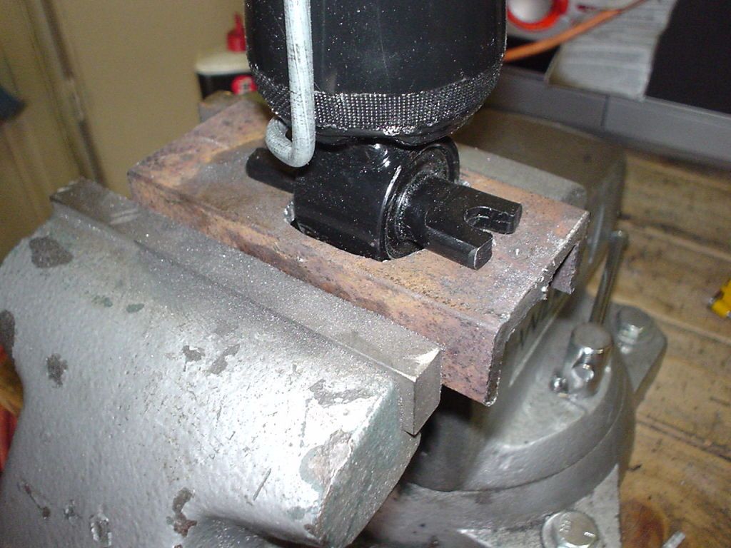

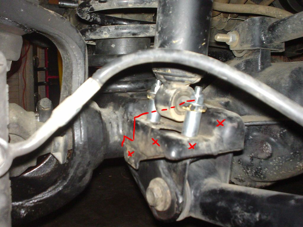

making some shock relocation mount for the front, to run N66L for 4" lift, on 2" of lift, with only 1.375" bumpstop extension (2" normally required).

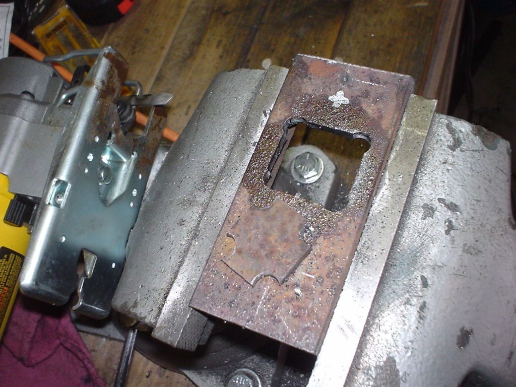

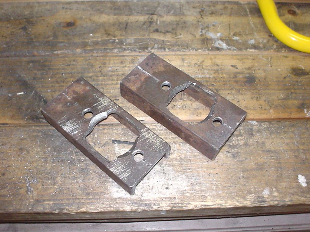

Cut two pieces of 1"x2"x3/16" C-channel. Set the shocks on top of them, and marked an outline with a sharpie.
Used a bench top drill press to drill four holes, then cut the center out with a jig saw.
Repeatedly test fit the shocks, and nibbled the rest of the material out using a dremel, die-grinder with cutting wheel, and a file.
Once the shock fit well, I marked the locations of the bolt holes and drilled a pilot hole, then a 5/16" hole for the shock bolts.

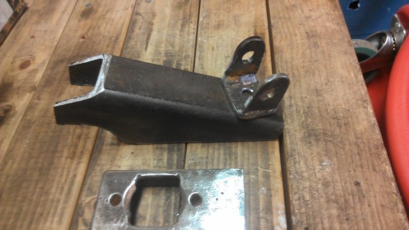

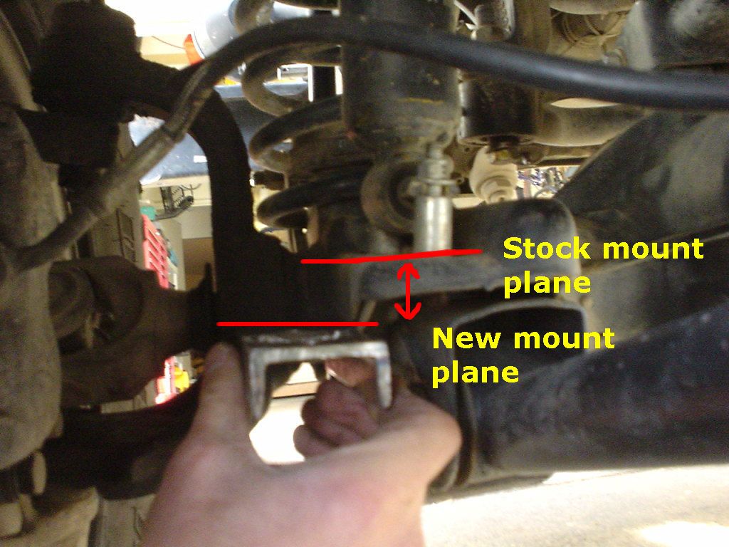

The plan is to cut the stock shock mount off, and reinforce the remaining hole in the spring bucket with some plate.
Then mount the new fabricated shock mount about 1" lower than the stock mounting plane, against the lower control arm mount.
Also fabricated rear relocation mounts out of a scrap piece of 2x5x3/16". Will be running N67L shocks for 4" lift, on 2" of lift, with ~1.5" bumpstop extension (2.5" normally required).
Here's the reasoning behind the change:
Current front shock length:
N66: 9" travel, 13.2" compressed length (14.2" with 1" extension), ~5" uptravel / ~4" downtravel
New front shock length, with relocated mount:
N66L: 11" travel, 15.5" compressed length, ~5" uptravel / ~6" downtravel
downtravel gain: ~2"
Current rear shock length:
N67: 8.8" travel, 13.3" compressed length, ~5" uptravel / ~4" downtravel
New rear shock length, with relocated mount:
N66L: 10" travel, 14.5" compressed length, ~5" uptravel / ~5" downtravel
downtravel gain: ~1"

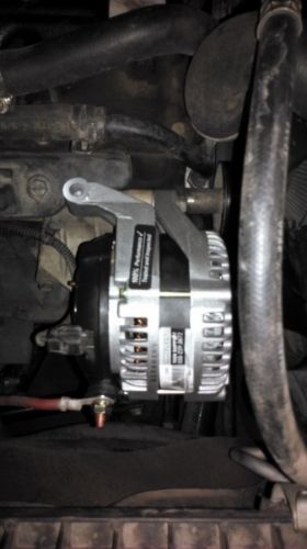

My alternator decided to give out. Installed a reman Duralast 160A Durango alternator. I still need to upgrade the wiring to the battery.

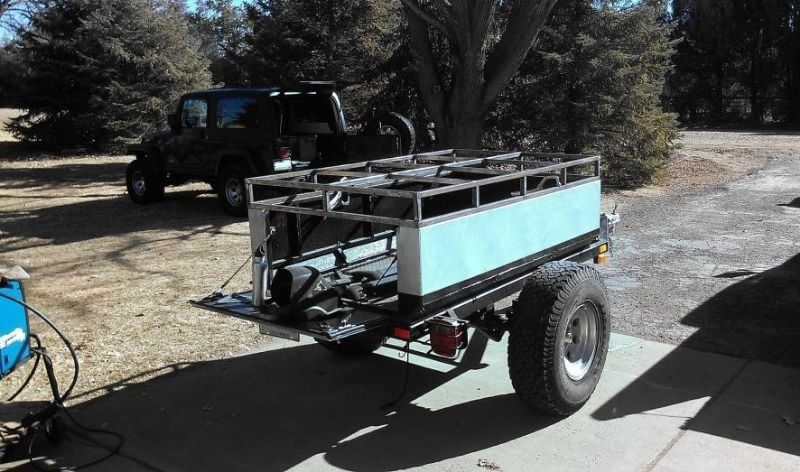

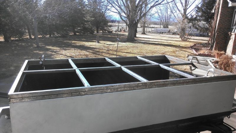

Making some slow progress on the trailer lid:
