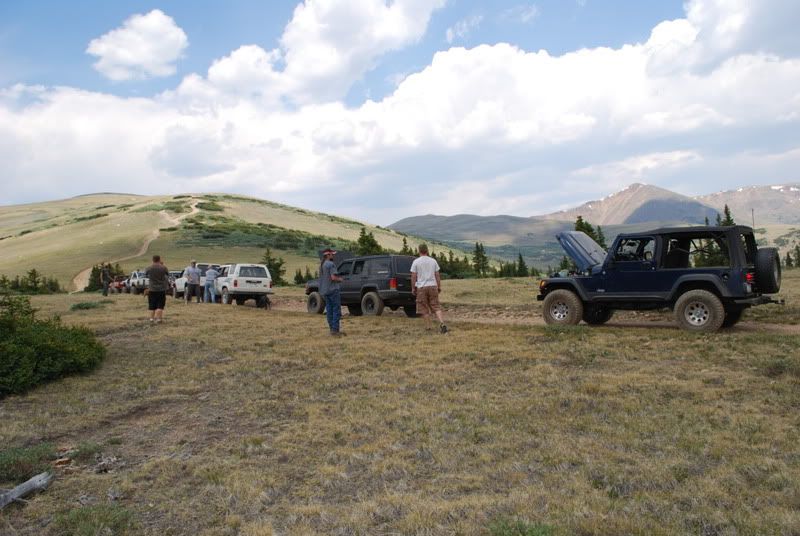

since it's been around 98-105F for like a week now, the trail was real busy with people trying to get up and enjoy the cooler temps at high elevation. we came across this group on the trail, who had previously stopped for another group which was in front of them. there was even more vehicles behind us too.
if you've been watching the national news, you've probably heard about the numerous wildfires in Colorado. You can see a good bit of haze in the pics.

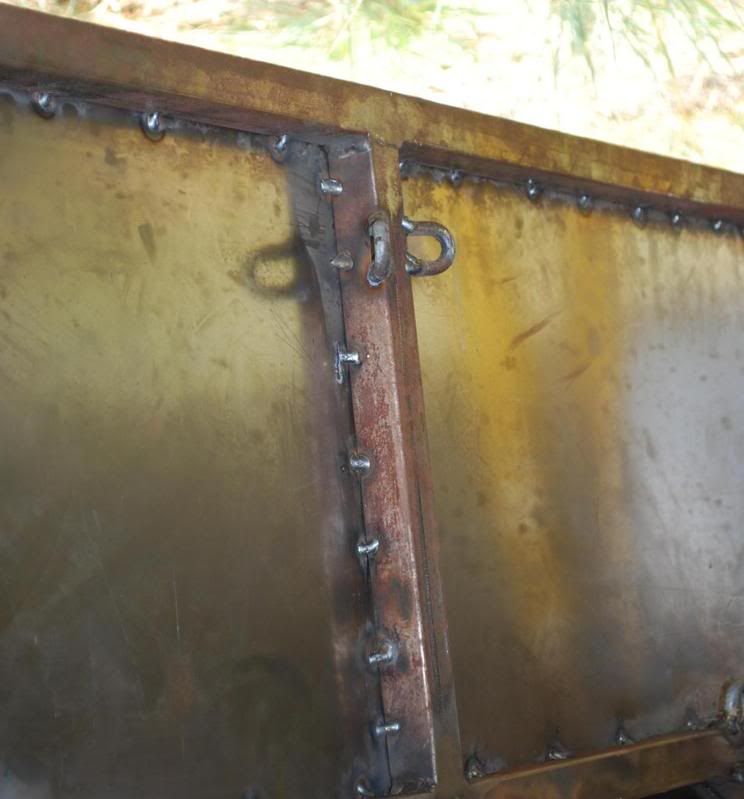

want to make some cheap tie-down points? take an old chain, cut a whole bunch of links with a grinder.
tack weld them all over the place!

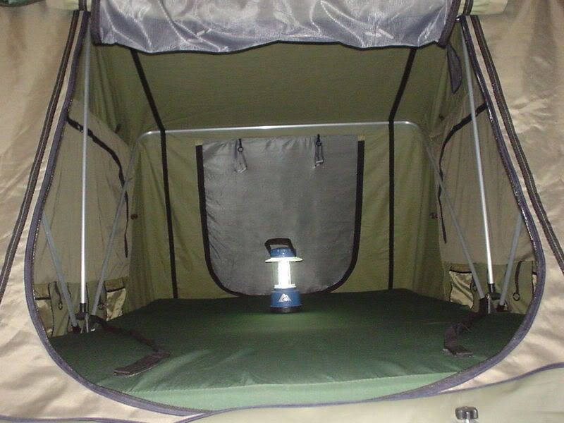

After months of patiently waiting/searching, craigslist provides once again. It didn't fit in the Jeep, so it had to go on top of the roll bars Obviously it will go on the trailer when finished
It's a Mombasa brand from Car-Top-Tent.com. The cover is trashed and will need replaced, but the rest of the tent is in great shape and hasn't seen much use. I think I got a fair deal on the tent, but I'll have to buy a new cover eventually (which costs $120+ ) Until then, I'll be attempting to repair this one with my rudimentary sewing skills.

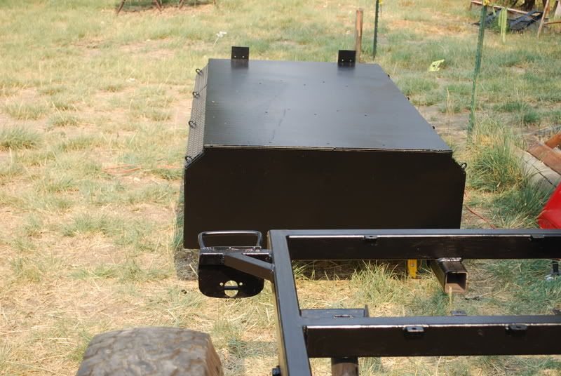

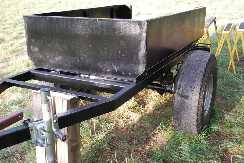

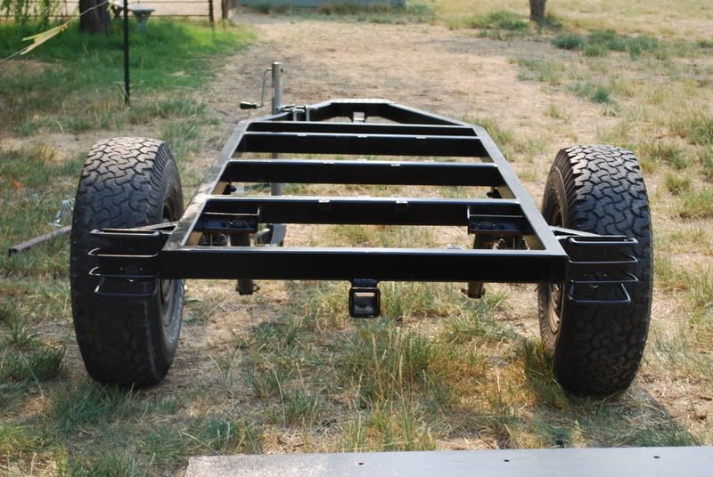

Chassis saver done. ready for caulking, body filler & Monstaliner.
Tent
Gotta build a lid next....

The trailer looks great , should make for a nice platform away from civilization . Whats the plans for the lid ?
tdittyrocks gave me two 200lb struts, I'll be using those. I may take a few ideas from his M416 trailer...the lid will be 1" square tubing like the tub, but I may use plywood for the sides instead of sheet steel to save weight.

i would advise aluminum
