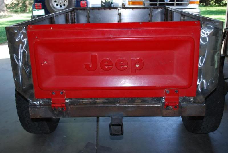

The trailer is looking good - going to paint it to match?
I'd love to do it in Patriot Blue, but I don't have the money. This is a low-budget build . I got some Monstaliner & chassis saver from a forum deal 2 years ago...I'll be doing my Jeep tub and the trailer at the same time. Exterior paint will be black or a silver/black combo.

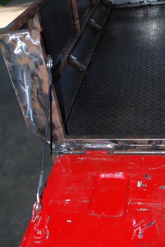

I'm not sure if you are planning on building a lid for your trailer or if these would work for your application, but I have 2 - 200# gas struts that you can have. They were a little light for my application and are collecting dust. Let me know if you want them.
