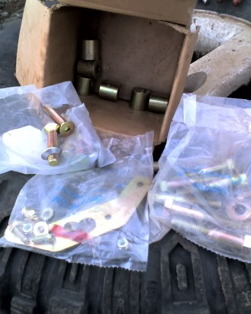

I've still got vibes from the driveline, but its not bad at all. Tolerable, but since I know thats the t-case vibrating itself to death, I'm going to start with stacking washers.
your's for shipping if you want it....
that 1"? for 2003+ metric bolts right?
Useful Write-Ups:
Fabrication & Build:
Funny:
Unlimited04 is offline
post #45 of 711 Old 05-18-2009, 10:18 PM
mudb8
want it rite or rite now?
mudb8's Avatar
Location: Estacada, oregon
Posts: 5,987
it has bolts for the early and late tj's... I'd have to measure the spacers, I don't remember how tall they are. It's been sitting around since 03 when I put the rancho on my rubi..
