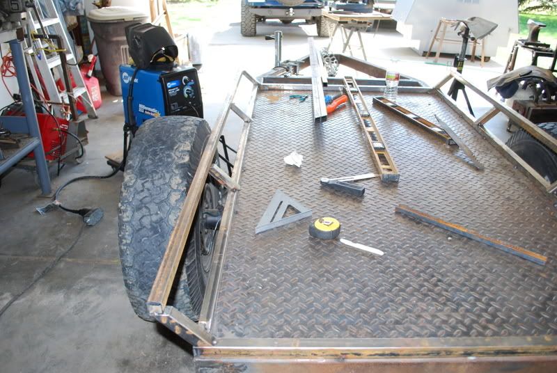

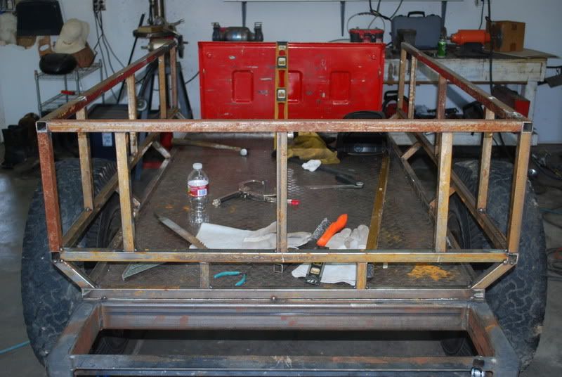

Sold my Hobart Handler 140 and got a Millermatic 211 Autoset (runs 110V & 220V). It hurts the wallet, but will pay for itself quickly
Put it to good use on the trailer:
The tub is taking shape...next up is framing the tailgate, finish welding, and add sheet metal.

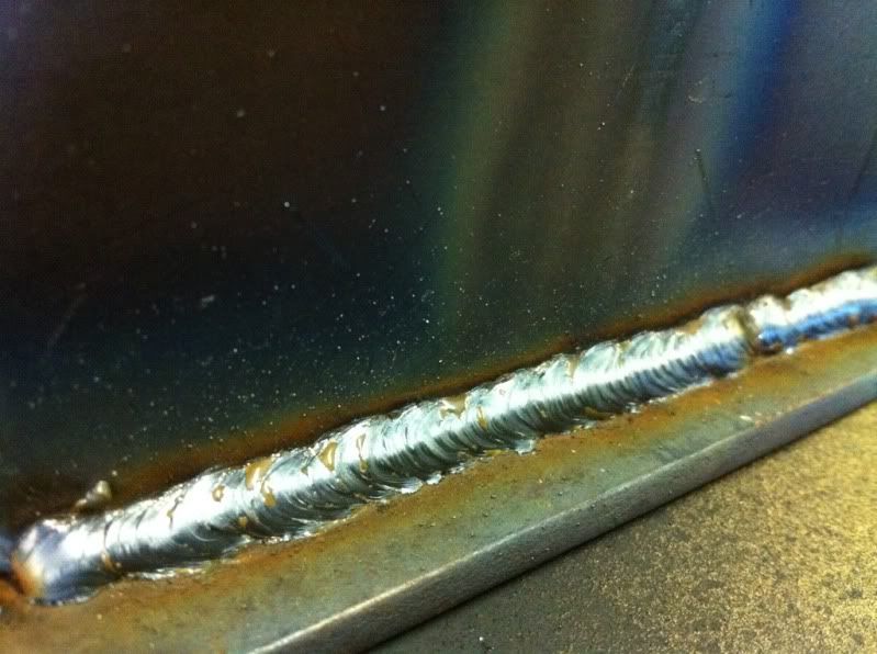

you'll really like that 211, i love mine. you'd be impressed with what it can do when you're burning with gas. these are my dicking around welds on 3/16ths plate before i left for the AF

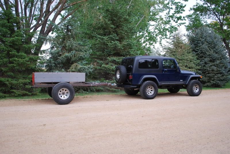

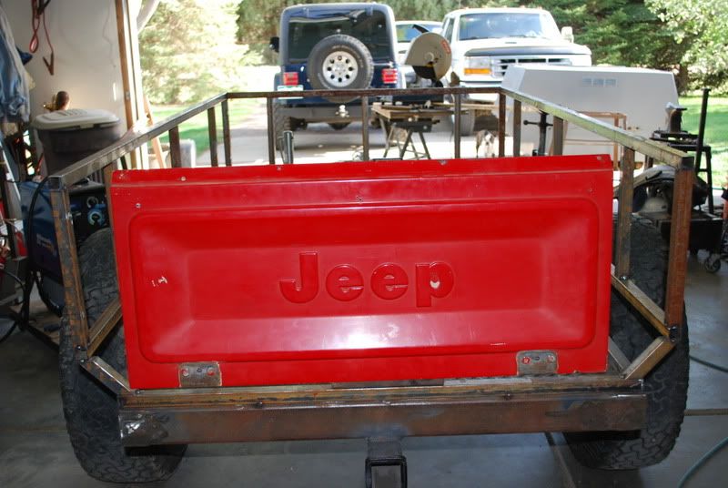

Here's another trailer picture, with Jeep tailgate frenched in....just need to drill and tap the hinge mounts now.

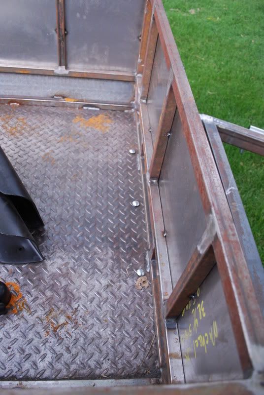

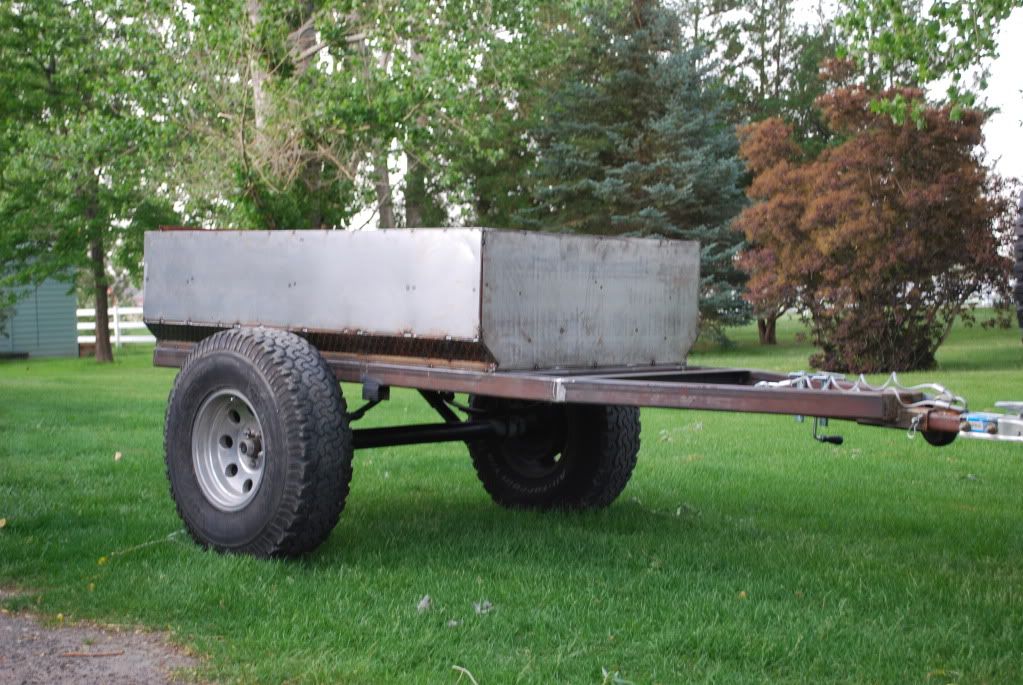

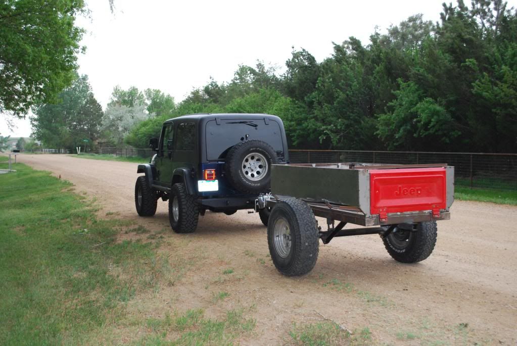

Trailer updates:
Sheet metal is almost done. Tub can be separated from the frame, and bolts in place with button head screws (15 of them ).
CJ tailgate is mounted & cables done....that was an ordeal. Busted off a tap and had to cut the whole mount off and make a new one, then drill & tap again. .
For the latches, I may do this:
http://www.jeepforum.com/forum/f9/lo...wners-1007833/
Next up: 7" wide TJ fender flare install, finish minor body work, caulk/seal tub, drain plugs, Chassis Saver, paint & Monstaliner.
