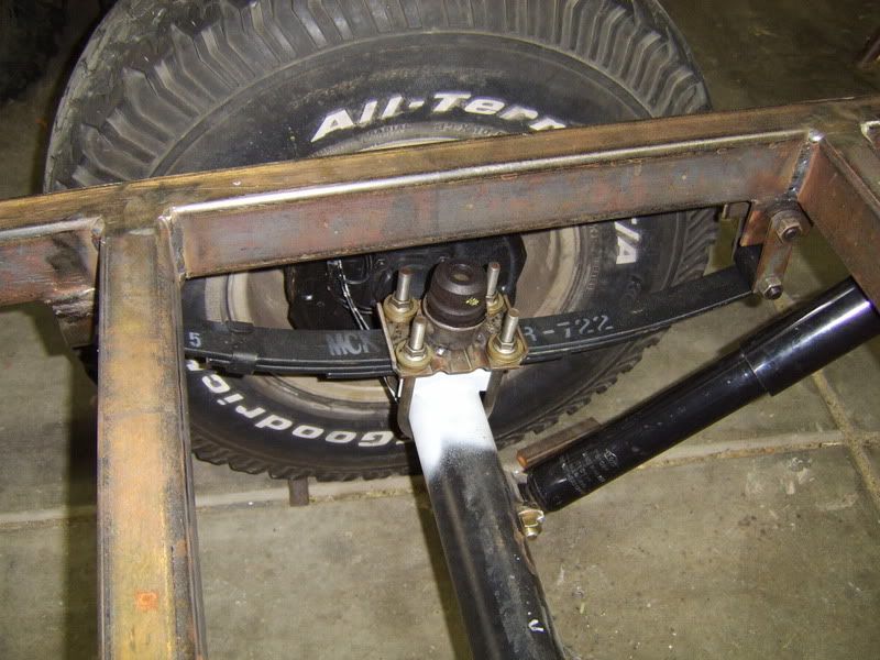

yea, i'm not crazy about how high it sits actually. I tried to do spring under axle, but there was only like 1/2" of uptravel and it wasn't going to work unless i fabricated new spring mounts. so....i had to do spring over. I could have gotten the frame about 3" lower if I outboarded the springs, but that would have been even more work. I will eventually hang a spare tire, storage and fuel/water cans under the frame to keep the COG low.
I pulled it on the road up to about 40mph, and my friend followed me. he said it pulls well centered and straight behind the jeep like belongs there.

Progress is looking good on the trailer. I had similar issues with my "bomb shelter" build and went spring over so I could match tires/rims with the Jeep. I'm at 28" clearance between ground and bottom of main frame currently. BUT, I've had it fully loaded a few times with pretty heavy loads, then pulled across uneven terrain-no issues, with the Lock and Roll hitch, it did very well. Better than expected even so I'd say you have nothing to worry about. Load it smart and you'll be fine. Looking at adding dual batteries to mine now for welder and winch duties... Probably going under the body, just above the axle for both batteries with leads running up to the tongue box for welder hookup, and whatever else I need there. We'll see how it works. Trying to keep any additional weight as low as possible. Likely have water tanks recessed in the frame as well at some point. How much does that weigh and are you adding sides? Looks pretty light-nice work!

[quote=Unlimited04;12710182]bar pin mounts for the stock XJ shocks...I think i'll change to slighly longer XJ shocks later, since these are pretty much fully extended here.
How much angle are on those shocks?? How effective are they?? Can you mount the upper mount in front of that crossmember?? Might have to use some short shocks though. Hard to tell in the pic...
I think you will be when your dragging it around the trails!
I like your under frame storage idea, that should help offset the height and lower center of gravity.
I doubt they'll be the most efficient shocks . The angle is pretty bad, but it's leaf spring, so the springs will move back with the shackles some anyway. I did try to mount them in front of the crossmember, they were too long...and I didn't want to mess with a shorter shocks. I may get a set of 2-4" lift XJ rear shocks if I can find a set for cheap enough.
The AT Chaser's have their shocks at a similar angle. If it bounces a lot or becomes a problem, I'll cut em off and move them...which won't be too hard since the tub, floor and all, will be removable with a few bolts.
