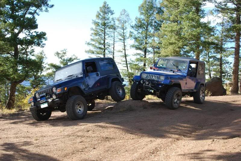

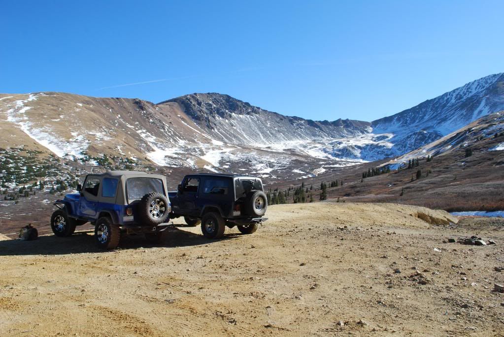

Met lynusann (never been wheeling) from the forum and we did some introductory wheeling.
Started at Rampart Range and we climbed the one obstacle
Then another weekend we hit Argentine Pass, which was partially snowed in already.

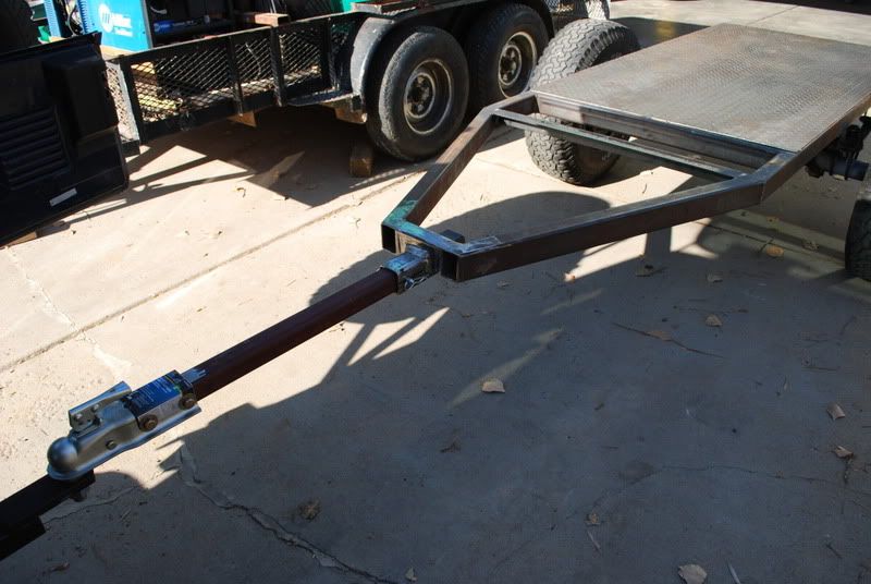

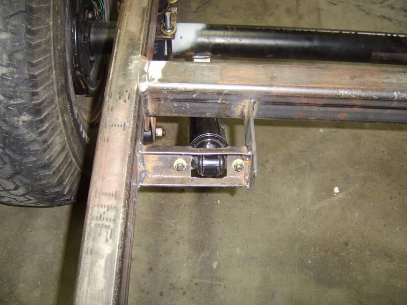

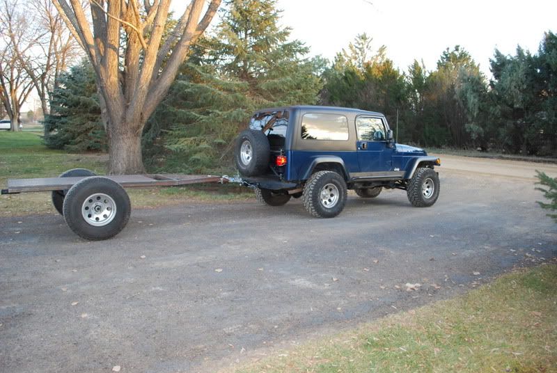

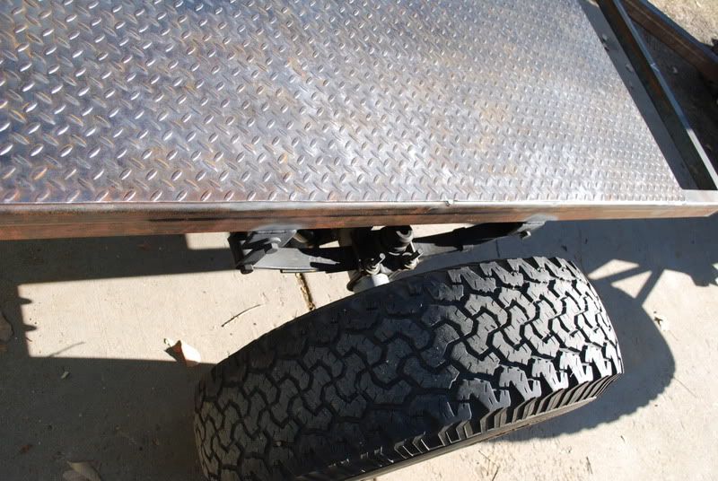

meanwhile, here's some progress on the trailer. we've had a lot of snow & cold, so I haven't done much work on it...these are from a few weeks ago. Floor is 1/8" diamond plate. 2" receiver on the back.
ZJ front bumpstops installed:
bar pin mounts for the stock XJ shocks...I think i'll change to slighly longer XJ shocks later, since these are pretty much fully extended here.
Extended tongue position
Close tongue position
