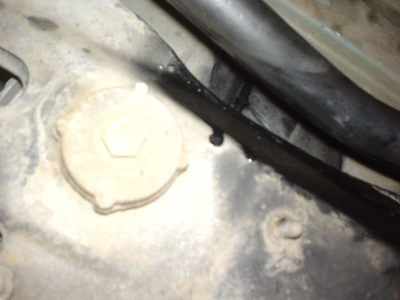

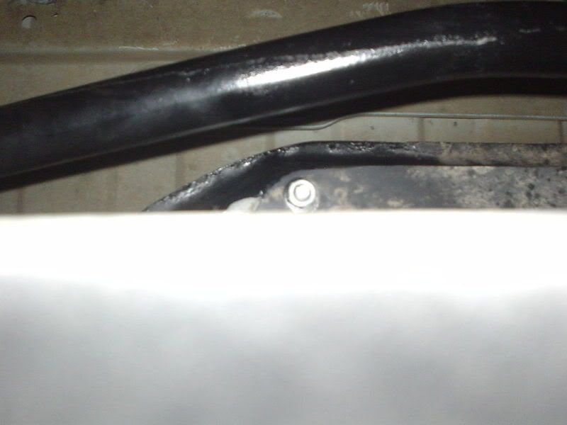

I decided to check my rear bumpstops. I worked up 1.3" of bumpstop extension, using my 23mm homemade bumpstop extensions, and some grade 8 fender washers.
Part 4:
I pushed the axle up to full bump to check the situation, and saw this:
Anybody see whats going on?
If you noticed the axle isn't at full bump, and actually has some uptravel left, you're correct. Now look at the OME bracket and the FUEL LINES. Yes, the bracket is hitting the fuel lines and causing some major binding since these lines are stiff hard lines!!!
another view:

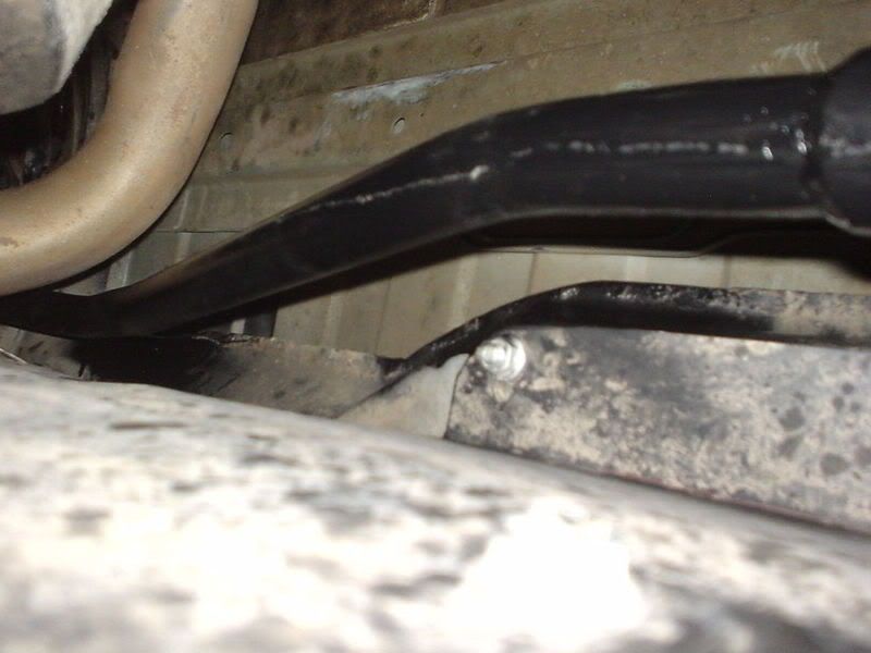

Part 5: The FIX!

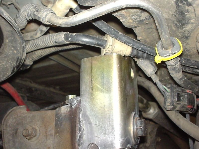

I had to pull more wire from the frame for the fuel pump electrical connector, and use some creative zip tie work to pull the fuel line closer to the frame and higher, actually almost up to the body.
Then I pushed the axle back to full bump.
It now clears, but notice how much further the bracket moves up!
You don't want to be binding your fuel lines at full bump. So remember to check full bump!

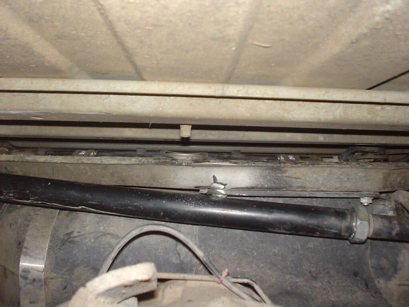

While testing full bump - I find the rear track bar doesn't work! It hits the gas tank mount, and the frame! After my issues with the JKS front track bar, it doesn't surprise me the JKS rear doesn't fit either.
This thing would require about 3" of rear bumpstop extension to fit. It hits SOOO hard, the track bar actually gets hung up on it! Big loud bang and the track bar moves past the bolt, and then it lifts above the frame (gas tank mount), and then gets hung up on the way back down! Ridiculous.
I couldn't get the stocker back in due to the pinion rotation, so I'm stuck with this JKS till I can fix it. I'll be going to my friend's shop, where he has a tubing bender & fab equipment, and seeing if we can put a bend in it to avoid the interference. What's really frustrating, after all my front track bar issues, this seem like an easier track bar to make from a design standpoint.
I can see no reason why this bar can't have a bend around the gas tank mount. I emailed JKS on the subject...we'll see what they have to say..... I think they're tired of me pointing out the major design flaws in their track bars.

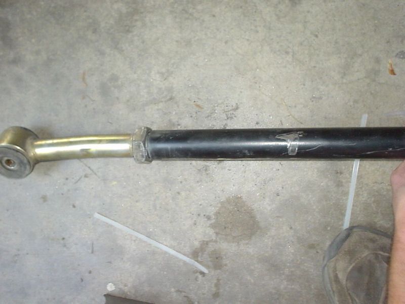

Rear track bar fixed thanks to my friend and a few hours of his time and shop use.
I wanted a flex joint of some type on the axle end, and a stock Clevite on the frame side. So as opportunity knocked, I bought a used RE 1620 track bar & CV bracket off Co4x4.org. Then we heated up the stock track bar (1" solid steel) with an oxy-acet torch, and put two bends in it. First try was way off, so we heated it up again, bent it again. 2nd time the bend looked great, so we hacked off the axle end. We then hacked off the axle end of the RE1620 to use the heim end on the newly bent stock track bar. We ground down the edge of the stock bar to sleeve the RE1620 over it. Two rosettes were cut/drilled in the heim side for welding later. We then reinstalled the bar, set the Jeep approx. to ride height and tack welded the pieces together. We then cycled the suspension to full bump and full droop to check the fabricated track bar. It was discovered one section of the frame above the exhaust rubbed by about 3/8" or 1/2" (in the last 5/8" of uptravel), but otherwise the track bar fit GREAT!
So while he was TIG welding the track bar ends together, I covered the gas tank with a welding blanket and ground a clearance section into gas tank mount of the frame.
Hopefully the heim end holds up well, little worried about the smallness of the diameter of the threads & RE's bung, but time will tell. At least it clears at full bump and only slightly rubs the exhaust at full droop (and only at 2" past my current shock length). The rear suspension is dialed in
I didn't get many pictures because we were trying to work fast, but heres the done pics:
Clearance grind in passenger side of frame:
So if we can do it with an oxy-acet torch and a piece of exhaust tubing as a bending lever, the aftermarket should be able to do it with their fancy benders
