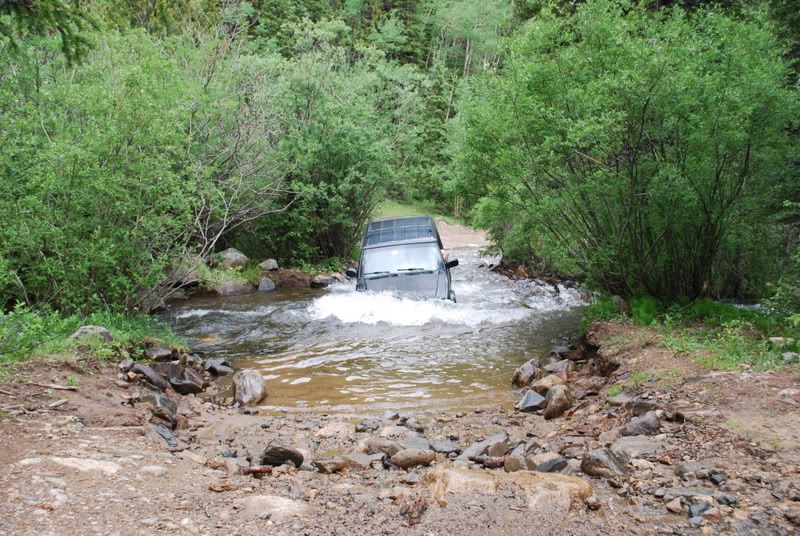

I hit up Argentine Pass/McClellen Mtn this weekend & had a blast. We couldn't get anywhere near the top, we just fooled around treeline and around the trails surrounding the mines. Theres still a bunch of snow up there, but we did make it to 12,000 ft or so.
Here's COLOUXJ trying to see if an XJ will float...water crossings were still deep

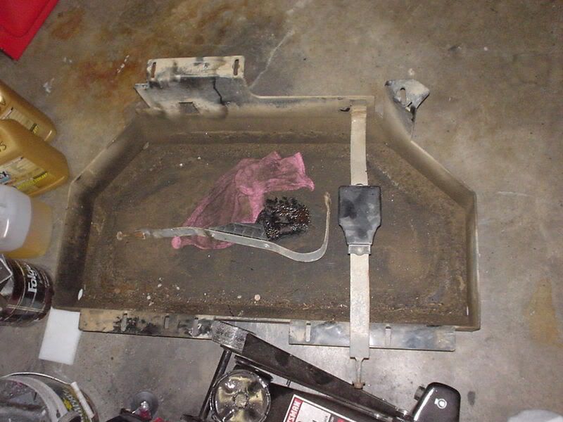

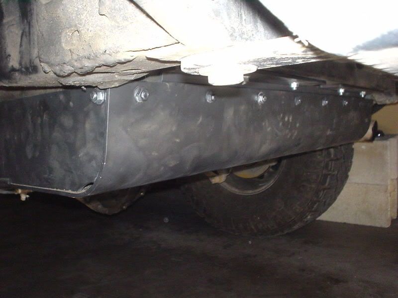

Out with the Kilby:
In with the Savvy:
And I absolutely hate the plastic Jeep fuel line connectors and emissions connectors. Absolutely hate them. I got frustrated .
The Savvy tank was nice and easy to install, and I love how they include all new hardware and a bunch of Christmas trees. very helpful, makes life sooo much easier.

post #341 of 711 Old 07-24-2011, 05:32 PM
2006_Sport
Location: Sherrills Ford
Posts: 10,823
NICE! I like. I think I want a savvy gas skid, after i beat my stock one to piss
2006_Sport is offline

Thanks
The Savvy is clearly the best option for a gas tank skid right now, no question at all. I'm really impressed with clearance increase of the Savvy over the Kilby. As you can see, the Kilby had collected a few lbs of dirt and diff oil. I spent a lot of time cleaning the tank, frame & spout and I'll have to spend even more time cleaning the Kilby before I can sell it locally. I can't wait to get this Savvy skid on the trails and bash the hell out it.

post #343 of 711 Old 07-24-2011, 08:18 PM
Jay12
Location: Gainesville
Posts: 2,219
You'll be happy with it. I had the 97-02 stock skid and it was beat to hell and coming apart. No issues so far with the savvy skid and I've come down pretty damn hard off some dropoffs a few times so far on it.
