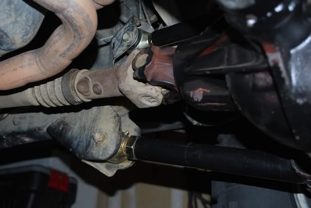

What is the purpose of this mod?

you never have to remove the fill or drain plug again, and since the steel plugs tend to gall the aluminum case pretty easily, this is a good thing.
I bought maybe 3 ft of this oil resistant clear tubing. One small piece is on the t-case as shown above, the other piece I attached to a small funnel. No more mess when filling/draining the t-case! Just unhook the upper part of the hose, snake it down the drain hole in my skid to a waste bottle. When filling, just attach the funnel hose, fill until the level is correct, reattach the hose and i'm done.
Aaah I see... thanks!

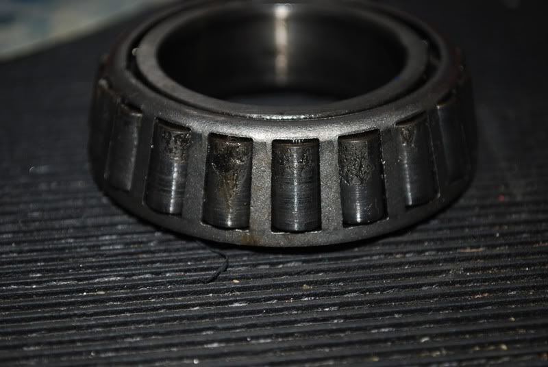

4.88s are in finally.
and this is why you get new bearings when you do a regear. this is what the junkyard HP D30's carrier bearings looked like...this was the bad side.
don't cheap out, buy the master install kit
