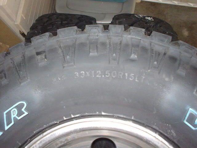

31s:
Steelie 16x8 Soft-8 wheels = 37 lbs
245/75R16 BFG AT = 48 lbs
Total: 85 lbs.
33s:
Procomp 1069 15x8 wheels = 16 lbs
33x12.50R15 Duratrac = 48 lbs.
Total: 64 lbs
Thats a 21 lb savings between each tire/wheel assembly, and 84 lb savings between all 4 rotating tires. Including the bald 33x12.50R15 BFG AT spare, thats a 100 lb savings moving from 31s to 33s.

I put the 31s back on so i can actually drive on the highway.
around town under 50mph, with OD off, it wasn't too bad. but going uphill in 2nd or 3rd at lower speeds it would bog down and require alot of throttle. tranny shifted like crap, but thats nothing new. With 33s, the engine idling at 600rpms actually didn't have enough torque to roll the vehicle forward from standstill in 1st gear.
on the highway OD was worthless unless going over 75mph. below 55-57-ish mph, i sometimes kicked into 2nd to merge, pass or regain speed if someone cut me off. I didn't dare go into the mountains, but climbing gentle hills just on the highways around denver had me using 2nd and 3rd to maintain 55-65mph. At 60mph in 3rd, it turns 2200rpms, in OD, it turns ~1500. Worthless.
In short, it was worse than the 17 ft U-haul box truck i drove 2 weeks ago....hence 31s are back on until HPD30 swap/regearing is complete. Btw, speeds measured via GPS, not inaccurate speedo. Also keep in mind i'm at 5300 ft elevation, i can only get 12 psi MAP at full throttle, if i'm lucky.
i found a good air pressure range, the C-load rated 33s ride much better, less tire shimmy, but i still need to fix something in the front end. oh well, HP D30 will be done as soon as my OTC ball joint adapters get here.

thanks wheels i got used from craigslist (5 for $180, $36 each). a few of the rim edges have bad rock rash, but they're all straight and actually have less runout than my previous new 15x8 steelies did.

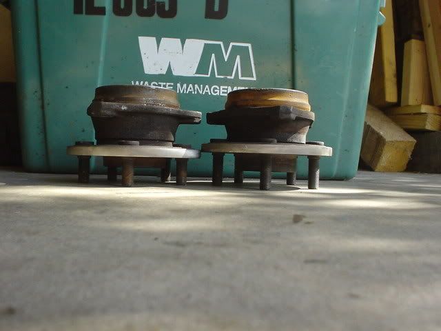

So I'm getting the Explorer rotors mocked up, grind both HP wheel bearings down to fit and start to put the calipers on the knuckles....had it almost done, but couldn't figure out why one side wouldn't seat right...upon closer inspection...I know why the XJ this HP came from was in the junkyard with brand new brakes on the front. It had two different unit bearings on it. I don't have the original parts anymore to check, but I sold the calipers and pads since they were brand new. Well somebody put the wrong unit bearing on!! The owner must have traded it in CFC because the damn brakes wouldn't work right!!
Old style on the left, new style on the right.

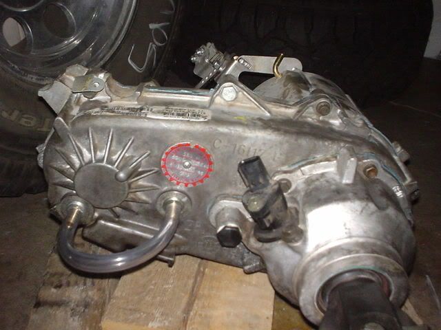

I also did Knuckelhead's clear tubing mod to the t-case.
I pulled the drain and fill plugs out, drilled and tapped for a 1/8" NPT fitting. The drill size is "R", and you need two brass fitting thats are 1/8"-27 NPT and barbed for 3/8" hose.
The hardest part is grabbing onto the threaded plugs - I used an old 5/8" rubber hose in the vice and tapped really slowly...1/2 turn in, 1/2 turn back. Make sure to not tap too deep, otherwise you won't get enough interference fit on the plug to create a proper seal.
Now I'm lubricating the tub

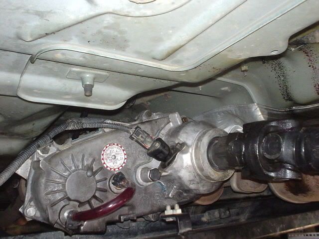

Pinion angle is dialed in using Rokmen control arms:
Drives smooth as stock! perfect! driveshaft might be a little too long...still need to measure and find out exactly.
Lowers are stock length (15.75"), uppers are a fuzz over 13.75", about 13-13/16". The Riddler diff cover hits & rubs the Kilby gas tank skid..... I'll need to get a new diff cover.
